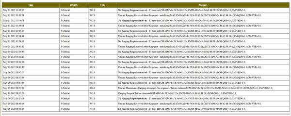

then for most off the day my cable modem has this error message No Ranging Response received or Unicast Ranging Received Abort Response.

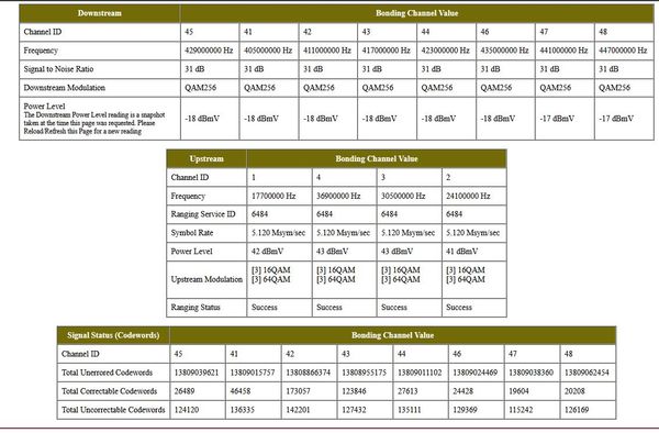

my signal was -18dbmV without a booster (when I moved in). with a booster it was -3dbmV.

      signals on 4-24-2022 no signal booster

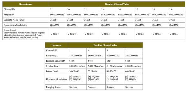

      signal levels from a few minutes ago no signal booster one splitter
      logs from today it only shows what you see.

        Looks like your SNR improved and DOWN power within range.  Looks like channels 1 and 4 lost a little UP power.
        What's your uncorrectables look like today?

    The tech definitely improved your DOWN power and SNR.  Your UP power, however, seems good just not great.
