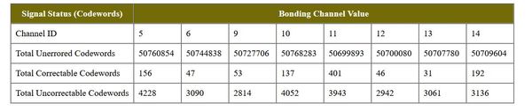

signals on 4-24-2022 no signal booster
signal levels from a few minutes ago no signal booster one splitter
logs from today it only shows what you see.

Looks like your SNR improved and DOWN power within range. Looks like channels 1 and 4 lost a little UP power.
What's your uncorrectables look like today?
- Flinx3 years agoContributor
I did not choose tp go without a booster the cox tech removed it.
uncorrectables are always very high the above is from 15 minutes after reset.
