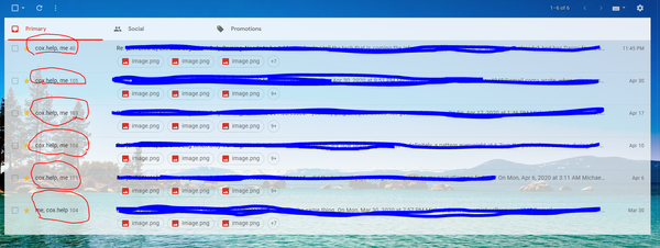

        all these emails with countless pingplotter data, and still no fix.
