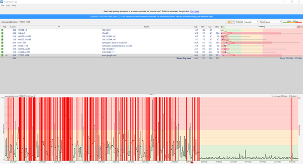

I have noticed something interesting however. My ping generally looks something like the following:
However when I download a file for example on Steam, my latency and packet loss suddenly fixes itself.
You can see above right where I start downloading something. I might add that this effect only happens when I download at my max speeds, if I throttle my connection to anything lower than the maximum it stays inconsistent.

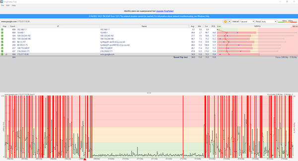

Here is another picture showing both before and after I download for a bit, you can clearly see the start and stop.

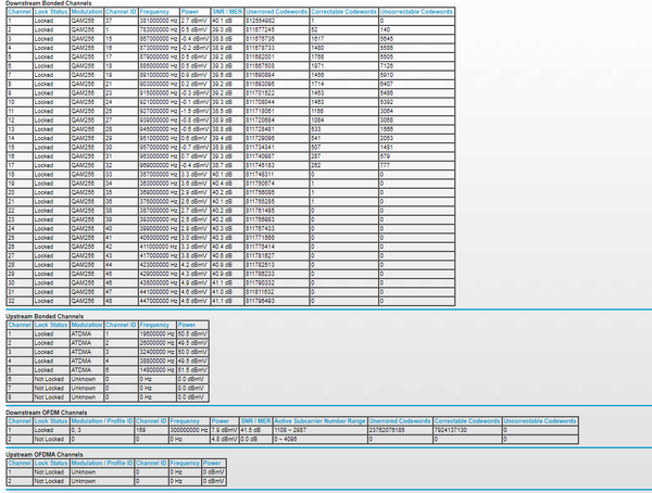

Here are my modem levels if that is needed. I have a CM1000 and a Nighthawk X4S. This is a new modem (replaced it a couple months ago because I thought it was the issue), and yes I have already tried bypassing the router. Multiple Cox techs have confirmed the issue is outside of my house
