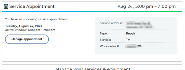

Excellent I thought. I later went on the Cox website to check to see if there was any appointment data....
Looks like a house-call for a TV problem. TV? I don't even have Cox's TV service!

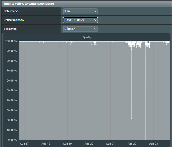

Here's my line quality, based upon pinging 1.1.1.1 in my router.  This is the last 7 days:

      I understand completely what you're saying. I don't have a real speed problem.
      Latency and speed aren't too related, although your average speed will drop with excessive packet loss.  You can have the best ping time in the world, and if some of those packets get dropped, especially in UDP or other streams which don't use acknowledgements, you'll feel it in gaming, streaming, etc.
      This is a common occurrence for us here. Squirrels chew the cables, causes opens, shorts, intermittents, and that compounded with line noise just makes the whole internet experience poor.
      My pain is with this happening multiple times a year, and having to jump through hoops to get it looked at.

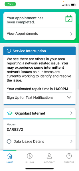

      Next thing I know, there's an outage notification in the Cox app:
      Once the notification was cleared, I set away my Pingplotter again.... it looks like it was great overnight, and then after 10 this morning it all went to heck again:
      The saga continues......

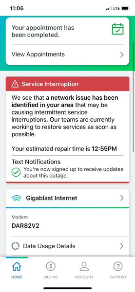

        Now I have an additional outage notification.
        I'll update afterwards. At least this shows they know about it, right?
