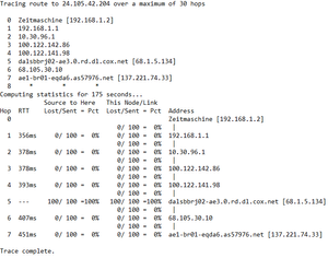

The packet loss you're seeing on hop 5 isn't true packet loss. If it were, you wouldn't be able to get any traffic to hops 6 or 7. Some routers drop ICMP packets and this can cause results like the one you posted. The most interesting thing I see in your post is the 363 ms RTT to your router. Are you testing this on wireless? If so, test on wired and see if there's any difference. I would expect the first hop to be close to 0 ms on wired and even on wireless it should be in the low double digits at most. 363 is very abnormal.

But as I said, this one might not be a cable internet problem. It looks more like a problem with your router or network.
