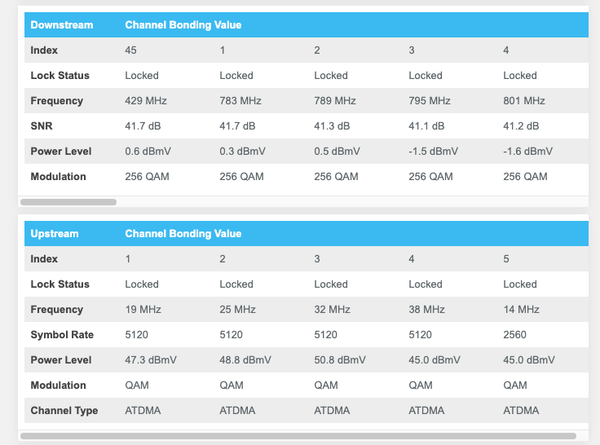

    Do you have a Cox Panoramic gateway? If so, post your signal levels from 192.168.0.1 > user:admin password:password (unless changed) > Connection > Cox Network. The downstream and upstream levels are of concern. You can either upload a screenshot here by joining the Internet forum or upload it to Imgur and post a link. See here for more instructions uploading a file. If not possible, check the levels themselves. The downstream should be between +5 to -5dB and SNR should be above 35. Upstream should be below 50.

      I think this is what you're requesting. If I'm reading the right numbers, they appear to be in the ranges you suggested. I will say my current uptime is 3.25 days, so maybe something has worked itself out?

        I would say your upstream is a little high on channel 3 and might be causing a problem. Hard to say without looking at the event logs but I don't think that model has any. Do you see any T3 timeout errors in the logs you can see?
