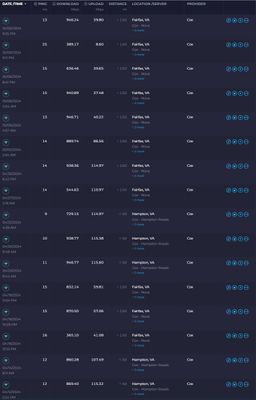

First, it's not GIG, it's Megabytes per second.
Second, 4K tv requires between 15 - 50 mbps, depending on the level of compression, HD requires 5mbps, so unless you are uploading uncompressed 4k, 35 mbps is more than enough for streaming up.
Third, your wifi vacs and bulbs do not use internet normally, they use internal LAN connectivity, and your WAN speed has no affect on them, and your security cameras, unless they are recording to an external to your home dvr, they also would be on the LAN. If they record to a third party DVR however, they could be using a LOT of bandwidth.
MY Internet is 500 down/50 up,
I stream up and down with ZERO issues. In fact the other night I was streaming to my daughter's 4k tv a wuxia tv series I have, while I was watching "The Blacklist" on Netflix at 4K.
