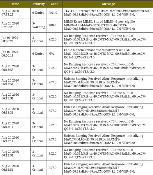

Cox connection drop @85044
Please see above logs in modem and cox fix this pls, I tried with 3 different modem, issue started 3-4 weeks ago
Are these better? I changed back to my modem that was verified working in optimal condition by cox technician a year back. I just started seeing issues 3-4 weeks ago and had to swap and try with other modem.( The log earlier posted was from router /modem combo netgear c3000. )
That still a lot of errors. And the SNR looks low. Can you post the logs too? When you changed the cable, was the modem unplugged from power? If you don't know how to post the logs you would need a Cox representative to look at those for you.
Aug 20 2020 07:55:25 | 6-Notice | I401.0 | TLV-11 - unrecognized OID;CM-MAC=d0:39:b3:f8:cc:46;CMTS-MAC=00:38:df:9b:d9:ce;CM-QOS=1.1;CM-VER=3.0; |
Aug 20 2020 07:55:25 | 5-Warning | Z00.0 | MIMO Event MIMO: Stored MIMO=-1 post cfg file MIMO=-1;CM-MAC=d0:39:b3:f8:cc:46;CMTS-MAC=00:38:df:9b:d9:ce;CM-QOS=1.1;CM-VER=3.0; |
Jan 01 1970 00:00:26 | 3-Critical | R02.0 | No Ranging Response received - T3 time-out;CM-MAC=d0:39:b3:f8:cc:46;CMTS-MAC=00:38:df:9b:d9:ce;CM-QOS=1.1;CM-VER=3.0; |
Jan 01 1970 00:00:18 | 6-Notice | N/A | Cable Modem Reboot due to power reset ;CM-MAC=d0:39:b3:f8:cc:46;CMTS-MAC=00:38:df:9b:d9:ce;CM-QOS=1.1;CM-VER=3.0; |
Aug 20 2020 06:13:55 | 3-Critical | R02.0 | No Ranging Response received - T3 time-out;CM-MAC=d0:39:b3:f8:cc:46;CMTS-MAC=00:38:df:9b:d9:ce;CM-QOS=1.1;CM-VER=3.0; |
Aug 20 2020 06:13:51 | 3-Critical | R07.0 | Unicast Ranging Received Abort Response - initializing MAC;CM-MAC=d0:39:b3:f8:cc:46;CMTS-MAC=00:38:df:9b:d9:ce;CM-QOS=1.1;CM-VER=3.0; |
Aug 20 2020 06:13:31 | 3-Critical | R02.0 | No Ranging Response received - T3 time-out;CM-MAC=d0:39:b3:f8:cc:46;CMTS-MAC=00:38:df:9b:d9:ce;CM-QOS=1.1;CM-VER=3.0; |
Aug 20 2020 06:13:31 | 3-Critical | R07.0 | Unicast Ranging Received Abort Response - initializing MAC;CM-MAC=d0:39:b3:f8:cc:46;CMTS-MAC=00:38:df:9b:d9:ce;CM-QOS=1.1;CM-VER=3.0; |
Aug 20 2020 06:13:11 | 3-Critical | R02.0 | No Ranging Response received - T3 time-out;CM-MAC=d0:39:b3:f8:cc:46;CMTS-MAC=00:38:df:9b:d9:ce;CM-QOS=1.1;CM-VER=3.0; |
Aug 20 2020 06:13:11 | 3-Critical | R07.0 | Unicast Ranging Received Abort Response - initializing MAC;CM-MAC=d0:39:b3:f8:cc:46;CMTS-MAC=00:38:df:9b:d9:ce;CM-QOS=1.1;CM-VER=3.0; |
Aug 20 2020 06:12:51 | 3-Critical | R02.0 | No Ranging Response received - T3 time-out;CM-MAC=d0:39:b3:f8:cc:46;CMTS-MAC=00:38:df:9b:d9:ce;CM-QOS=1.1;CM-VER=3.0; |
Aug 20 2020 06:12:51 | 3-Critical | R07.0 | Unicast Ranging Received Abort Response - initializing MAC;CM-MAC=d0:39:b3:f8:cc:46;CMTS-MAC=00:38:df:9b:d9:ce;CM-QOS=1.1;CM-VER=3.0; |
Aug 20 2020 06:12:31 | 3-Critical | R02.0 | No Ranging Response received - T3 time-out;CM-MAC=d0:39:b3:f8:cc:46;CMTS-MAC=00:38:df:9b:d9:ce;CM-QOS=1.1;CM-VER=3.0; |
Aug 20 2020 06:12:31 | 3-Critical | R07.0 | Unicast Ranging Received Abort Response - initializing MAC;CM-MAC=d0:39:b3:f8:cc:46;CMTS-MAC=00:38:df:9b:d9:ce;CM-QOS=1.1;CM-VER=3.0; |
Aug 20 2020 06:12:11 | 3-Critical | R02.0 | No Ranging Response received - T3 time-out;CM-MAC=d0:39:b3:f8:cc:46;CMTS-MAC=00:38:df:9b:d9:ce;CM-QOS=1.1;CM-VER=3.0; |
Aug 20 2020 06:12:11 | 3-Critical | R07.0 | Unicast Ranging Received Abort Response - initializing MAC;CM-MAC=d0:39:b3:f8:cc:46;CMTS-MAC=00:38:df:9b:d9:ce;CM-QOS=1.1;CM-VER=3.0; |
Aug 20 2020 06:11:51 | 3-Critical | R02.0 | No Ranging Response received - T3 time-out;CM-MAC=d0:39:b3:f8:cc:46;CMTS-MAC=00:38:df:9b:d9:ce;CM-QOS=1.1;CM-VER=3.0; |
Aug 20 2020 06:11:51 | 3-Critical | R07.0 | Unicast Ranging Received Abort Response - initializing MAC;CM-MAC=d0:39:b3:f8:cc:46;CMTS-MAC=00:38:df:9b:d9:ce;CM-QOS=1.1;CM-VER=3.0; |
Aug 20 2020 06:11:31 | 3-Critical | R02.0 | No Ranging Response received - T3 time-out;CM-MAC=d0:39:b3:f8:cc:46;CMTS-MAC=00:38:df:9b:d9:ce;CM-QOS=1.1;CM-VER=3.0; |
Aug 20 2020 06:11:31 | 3-Critical | R07.0 | Unicast Ranging Received Abort Response - initializing MAC;CM-MAC=d0:39:b3:f8:cc:46;CMTS-MAC=00:38:df:9b:d9:ce;CM-QOS=1.1;CM-VER=3.0; |

Lots of T3 timeouts. Not normal. If you have checked all interior equipment then you need a Cox tech to fix it.
Thanks I just want to rule out my equipment being at fault and being charged 100$ for cox technician to come and point fingers at my equipment, all that I could do is use new cable, ensure no splitters and try with different modems, is there anything else I should check?
