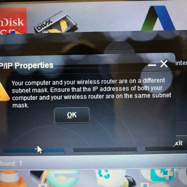

    So far I'm able to go inside the GUI of the RT, and I'm able to communicate with it change parameters and even went as far as updating the firmware to the latest one for the RT. After doing this I've connected the RT to the N300 LAN #3 to get a signal from it since the 4 connections from the TG are all been used. After doing this the RT gets it IP reassigned, to my understanding this new IP # reassignment I could be used to enter the settings. This is where I'm hitting a brick wall, with that new IP I can't enter the settings from the browser. I've even gone as far as using the "Asus device discovery utility" to configure and get an error "Your computer and your wireless router are on a different subnet mask. Ensure that the IP addresses of both your computer and your wireless router are on the same subnet mask".

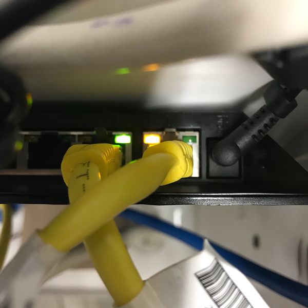

  • Bryan thank you, I did what you suggested but it seems the 1682 it's not allowing the RT to communicate. This why I think, I can jump on the N300 settings using the 192.162.x.x. So far that works without a hitch. But when connecting the RT to the WAN connection on TG-1682, this is what I get:
    This light is on the RT. Also when trying to access the GUI on the RT I get this message:

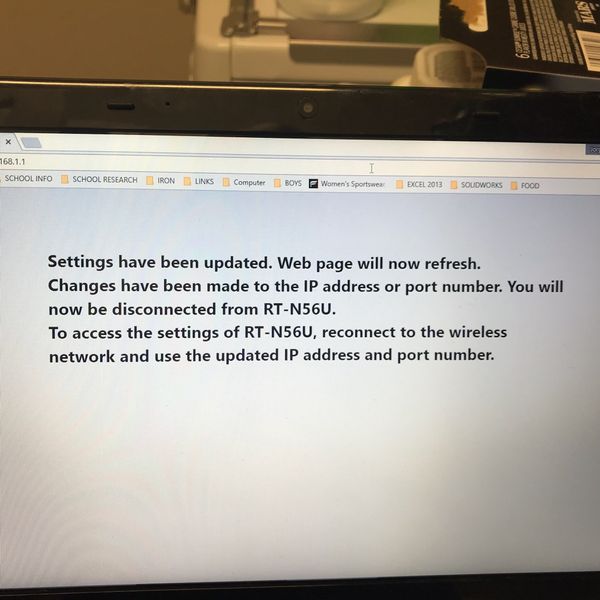

    This picture is using the asus finder
    When I try to enter the GUI using the configure button I get this message
