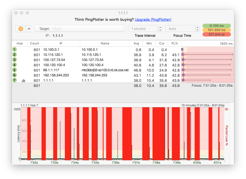

This looks like this:
and ping will return "Destination Host Unreachable".

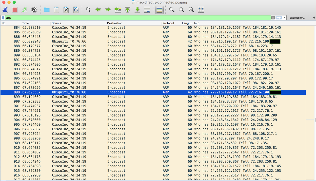

Here is the packet capture between me and Cox. You can see my router asking for the address of the cox gateway (72.216.100.1), but it doesn't (typically) get a response. Note that other responses are coming through fine from Cox and the connection itself seems fine with no packet loss observed.
The reason I get some connectivity back in the ping plotter image, is that Cox is broadcasting a lot of ARP requests. Sometimes those ARP broadcast will contain the the cox gateway IP (72.216.100.1) and hence my router can indirectly get the mac address. However, it seems like since those are inferred they get purged relatively fast from the ARP cache (or some other reason) and then internet connectivity is lost again.

  • Rob_H_'s avatar
    Rob_H_
    Contributor II
    The fact that the loss of connectivity doesn't occur with the static ARP table entry in your edgerouter means that we could rule out the RF side of the CMTS.  The question, as you demonstrated, seems to be what sometimes happens to your broadcast ARP request from your edgerouter when the packet moves beyond the RF side of the CMTS presumably to a switch before it reaches the default gateway?  Please come back and share the resolution.
