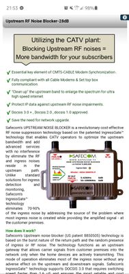

I've done everything I can on my end to mitigate the issues im having. All new coax in home. One brand new 2 way splitter for cable modem and TV box (-3.5db) All connections are firmly tightened and secured. Docsis 3.1 32x8 (2x2). Signal levels all in range T3 timeouts on event log. Cox has tested my lines in home and at the road. They say all it fine. Cox runs a ping plotter in my area...again, all is fine. My issue is terribly fluctuating upload speeds and this leads to drastic ping spikes which massively effects my gaming. Since cox has no idea what they are doing... is there anything I can do to mitigate this? I was doing some research and I saw this (image attached). Would something like this work? Or is there something that I can implement myself that will fix this issue? Last i heard from cox, they said my neighborhood has "Intermittent Noise Issues" Its been this way for years.. Way before Hurricane Laura Way before Covid 19. I need a miracle....somebody lol /resized-image/__size/320x240/__key/communityserver-discussions-components-files/5/Screenshot_5F00_20200830_2D00_215300_5F00_Chrome.jpg638Views0likes2CommentsPaying for tech to investigate Intermittent Service disruption (i.e. timeouts) in 85255
