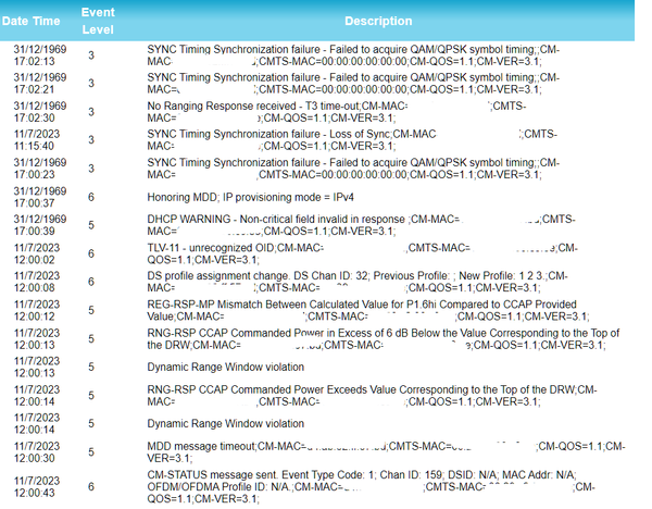

Below are the modem signal levels and details. Odd thing is, it looks like the modem got a firmware update since yesterday, as the login screen was different and my password no longer worked. I had to factory reset it to use the default login/password combo.

What I DO see is a problem with your downstream OFDM channel. It is registering a VERY low signal(-46dB) and doesn't show a SNR. Does that change when your speed changes? Either way, I would think a technician can troubleshoot that issue.
BTW, delete the second screenshot. It shows your MAC address which should be private.

As for your other comment about the logs, I see a lot of stuff that doesn't look right. But, I don't know any better either. Nothing that stands out as fatal or critical.
