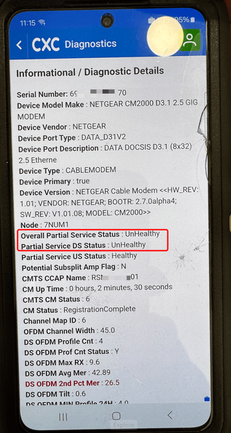

For the record, I have noticed that the Downstream Channel on that modem has been blinking, which means it's not on full service, and the Cox tech that came to my house even showed me that his testing equipment is also showing Unhealthy status

Just closing the loop on this communication. I purchased a Motorola B12 and got it replaced, and that resolved the speed issue. I am in contact with Netgear to have them replace my modem, obviously, it has some hardware fault going on.
