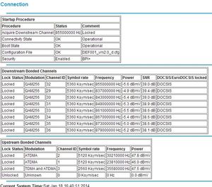

I have been battling an intermittent internet speed problem for the past month or so. I've had 3 visits from Cox technicians so far. As incremental changes are made by the Cox technicians and myself, the speeds are getting faster and more consistent (according to a 5-minute periodic test I've been running from TestMy.net). However, I am still stuck with the apparent inability to bond 4 upstream channels on my Cisco DPQ3212C cable modem. Below are my statistics (including my MAC address so you can identify me). Can you please tell me if there is anything that I can do from my end in order to get a better upstream connection? Thanks. Model: Cisco DPQ3212 Vendor: Cisco Hardware Revision: 1.0 Serial Number: 273127183 MAC Address: 68:ee:96:a1:3b:4b Bootloader Revision: 2.3.0_R1 Current Software Revision: d3200-P15-5-v302r125573-20131008a-COX Firmware Name: d3200-P15-5-v302r125573-20131008a-COX.bin Firmware Build Time: Oct 21 10:08:39 2013 Cable Modem Status: Operational Cable Modem State DOCSIS Downstream Scanning: Completed DOCSIS Ranging: Completed DOCSIS DHCP: Completed DOCSIS TFTP: Completed DOCSIS Data Reg Complete: Completed DOCSIS Privacy: Enabled Downstream Channels Power Level: Signal to Noise Ratio: Channel 1 : 5.7 dBmV 36.8 dB Channel 2 : 5.8 dBmV 36.8 dB Channel 3 : 6.1 dBmV 36.2 dB Channel 4 : 6.1 dBmV 36.4 dB Channel 5 : 7.3 dBmV 36.0 dB Channel 6 : 8.8 dBmV 36.9 dB Channel 7 : 8.9 dBmV 36.2 dB Channel 8 : 8.7 dBmV 35.9 dB Upstream Channels Power Level: Channel 1 : 47.5 dBmV Channel 2 : 46.7 dBmV Channel 3 : 49.7 dBmV Channel 4 : 0.0 dBmV4KViews0likes7Comments
