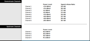

I recently got a modem upgrade to a Cisco DPQ3212, and I've been experiencing a slow internet connection since it got activated for about a month now. I'm not really sure what is the optimal level for the Downstream/Upstream Channels, but it looks off to me. With Splitter: With Splitter off:2.5KViews0likes3CommentsEqual upload speed
