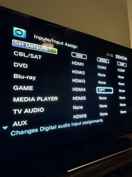

    I have a similar Denon receiver.  The digital inputs can be assigned - reassigned to different inputs.  Go in to the setup on your receiver and make sure that cbl\sat is configured to use the appropriate hdmi input, it's possible it could be flipped to a different input.  The menu would look something like this...

      I changed my tv. I am actually not sure when this issue actually started.  Also I think t+there was a denon firmware update. I'll try denons support next.  I have no device that sends sound over HDMI that the denon didn't detect and make sound.
      The cable box HDMI goes to the denon HDMI port 1 cbl/sat. The denon then goes to my tv HDMI port 2 that supports arc/earc.
