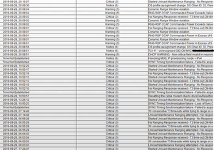

Can you please make sure there are no loose or damaged connections in the home? Please also ensure that any boosters, amplifiers or splitters are also in working condition. What issues do you normally experience? Is it slower than normal speeds or intermittent connectivity? While the signal levels appear to be within specifications, I am detecting tremendous packet loss on the modem. It may be best to send out a service technician. Please reach out to us at cox.help@cox.com, Facebook or Twitter so we can schedule a service appointment. -Kevin M. Cox Support Forum Moderator

No damaged connections. I even went as far as pulling the line that goes out of my house from the ground since it wasn't fully buried and making sure it was not damaged. No boosters or amplifiers...splitter working fine. If I try to online game, it will lag right off the bat and stop working (PC and PS4). Also using Netflix, Hulu or Plex, the speed will get slow and sometimes even stop working. I'll send an e-mail to cox.help. Thank You
