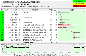

Hey everyone, For about two months now, I've been getting disconnects that last for 5~10 seconds, randomly throughout the day. I just checked my event log today and lots of errors that are common among these forums. My router is a Netgear CG3000D. My computer is the only desktop using a hardwire. I have a Antronix 2way 5-1000 splitter that i received last year from the Cox tech. I am very well versed in computers, but networking I haven't dipped into at all. I literally have no idea what is going on, but i'm sick of getting disconnects multiple times throughout the day. Any help would be amazing. Thank you, Cody V6.2KViews0likes7CommentsRandom Latency Spikes
Since last Friday I have been getting random latency spikes will playing World of Warcraft. The tracert and pathping look ok. I have the same problem whether my router is in place or not. Tracing route to 12.129.209.68 over a maximum of 30 hops 1 <1 ms <1 ms 1 ms Wigg2 [192.168.1.1] 2 7 ms 7 ms 7 ms 10.48.32.1 3 8 ms 7 ms 7 ms 172.21.0.204 4 11 ms 25 ms 11 ms chndcorc01-pos--0-3-0-0.ph.ph.cox.net [70.169.72 .48] 5 7 ms 7 ms 7 ms 70.169.75.153 6 21 ms 95 ms 21 ms langbprj02-ae2.rd.la.cox.net [68.1.1.19] 7 19 ms 21 ms 20 ms 216.156.65.9.ptr.us.xo.net [216.156.65.9] 8 37 ms 59 ms 35 ms 207.88.13.86.ptr.us.xo.net [207.88.13.86] 9 29 ms 28 ms 27 ms 207.88.14.226.ptr.us.xo.net [207.88.14.226] 10 40 ms 29 ms 39 ms 192.205.37.189 11 37 ms 38 ms 39 ms cr1.sffca.ip.att.net [12.122.200.10] 12 33 ms 36 ms 35 ms cr1.la2ca.ip.att.net [12.122.3.122] 13 33 ms 37 ms 33 ms gar20.la2ca.ip.att.net [12.122.128.181] 14 33 ms 32 ms 33 ms 12.122.251.190 15 34 ms 33 ms 31 ms 206.16.68.46 16 * * * Request timed out. 17 * * * Request timed out. 18 * * * Request timed out. 19 * * * Request timed out. 20 * * * Request timed out. 21 * * * Request timed out. 22 * * * Request timed out. 23 * * * Request timed out. 24 * * * Request timed out. 25 * * * Request timed out. 26 * * * Request timed out. 27 * * * Request timed out. 28 * * * Request timed out. 29 * * * Request timed out. 30 * * * Request timed out. Trace complete. Tracing route to 12.129.209.68 over a maximum of 30 hops 0 mcarter7.ph.cox.net [192.168.1.144] 1 Wigg2 [192.168.1.1] 2 10.48.32.1 3 172.21.0.204 4 chndcorc01-pos--0-3-0-0.ph.ph.cox.net [70.169.72.48] 5 70.169.75.153 6 langbprj02-ae2.rd.la.cox.net [68.1.1.19] 7 216.156.65.9.ptr.us.xo.net [216.156.65.9] 8 207.88.13.86.ptr.us.xo.net [207.88.13.86] 9 207.88.14.226.ptr.us.xo.net [207.88.14.226] 10 192.205.37.189 11 cr1.sffca.ip.att.net [12.122.200.10] 12 cr1.la2ca.ip.att.net [12.122.3.122] 13 gar20.la2ca.ip.att.net [12.122.128.181] 14 12.122.251.190 15 206.16.68.46 16 * * * Computing statistics for 375 seconds... Source to Here This Node/Link Hop RTT Lost/Sent = Pct Lost/Sent = Pct Address 0 mcarter7.ph.cox.net [192.168.1.144 ] 0/ 100 = 0% | 1 0ms 0/ 100 = 0% 0/ 100 = 0% Wigg2 [192.168.1.1] 0/ 100 = 0% | 2 8ms 1/ 100 = 1% 1/ 100 = 1% 10.48.32.1 0/ 100 = 0% | 3 8ms 2/ 100 = 2% 2/ 100 = 2% 172.21.0.204 0/ 100 = 0% | 4 11ms 2/ 100 = 2% 2/ 100 = 2% chndcorc01-pos--0-3-0-0.ph.ph.cox. net [70.169.72.48] 0/ 100 = 0% | 5 15ms 2/ 100 = 2% 2/ 100 = 2% 70.169.75.153 0/ 100 = 0% | 6 23ms 3/ 100 = 3% 3/ 100 = 3% langbprj02-ae2.rd.la.cox.net [68.1 .1.19] 0/ 100 = 0% | 7 24ms 1/ 100 = 1% 1/ 100 = 1% 216.156.65.9.ptr.us.xo.net [216.15 6.65.9] 0/ 100 = 0% | 8 36ms 1/ 100 = 1% 1/ 100 = 1% 207.88.13.86.ptr.us.xo.net [207.88 .13.86] 0/ 100 = 0% | 9 31ms 1/ 100 = 1% 1/ 100 = 1% 207.88.14.226.ptr.us.xo.net [207.8 8.14.226] 0/ 100 = 0% | 10 34ms 0/ 100 = 0% 0/ 100 = 0% 192.205.37.189 100/ 100 =100% | 11 --- 100/ 100 =100% 0/ 100 = 0% cr1.sffca.ip.att.net [12.122.200.1 0] 0/ 100 = 0% | 12 --- 100/ 100 =100% 0/ 100 = 0% cr1.la2ca.ip.att.net [12.122.3.122 ] 0/ 100 = 0% | 13 --- 100/ 100 =100% 0/ 100 = 0% gar20.la2ca.ip.att.net [12.122.128 .181] 0/ 100 = 0% | 14 --- 100/ 100 =100% 0/ 100 = 0% 12.122.251.190 0/ 100 = 0% | 15 --- 100/ 100 =100% 0/ 100 = 0% 206.16.68.46 Trace complete.3.8KViews0likes5Comments
