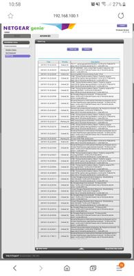

Hey all, I'm specifically looking for someone higher up at Cox to help me out here. I just moved into a new apartment with my girlfriend and signed up for a 100/10 internet plan. I bought a brand new Netgear CM600 cable modem and a router and set them up when we moved in and provisioned the modem and all seemed good, but I noticed our downstream power levels were a bit strange; the first 16 channels were ~18 dBmV and the last 8 were ~ -17 dBmV. I did some research and seems like these levels are supposed to be around 0, with a range of -10 to 10 dBmV. No problem, I'm an engineer at a satellite communications company and have plenty of attenuators at work. Grabbed a few and have been experimenting with different values, got the levels to 7 dBmV but we were still getting a ton of correctables on the downstream channels and frequent disconnects. I caved and had a technician come by today but right off the bat I knew he wasn't going to be too helpful. He switched out the coaxial cable to the modem and put an attenuator on it, then showed me on his phone that all the downstream channels were green and had "stabilized". I asked if he could take a look at the connections to the apartment but he refused. It's been ~6 hours since he's left and we're still having disconnects and the modem is rebooting. Find screenshots of my power levels and event logs below, about half an hour after manually rebooting the modem. I was going to wait a couple days before scheduling another tech visit but I don't want to go through this process again when there's a chance of getting another tech who isn't going to do anything I haven't already done. I know it's not the tech's fault, so I was still very polite to him, but I really need this issue to be resolved ASAP! So please, if there are any Cox employees on here who would be able to help me look into this, I'd be very appreciative 🙂 Thank you so much in advance!4.9KViews0likes3CommentsHigh Uncorrectable Errors
