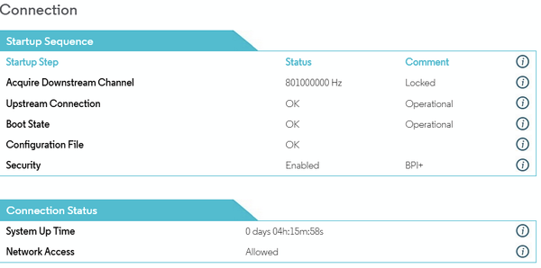

The only way to get the downstream arrow to stay solid blue is to reboot the modem.

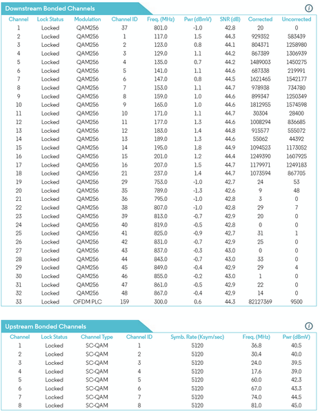

I have the following connection details for the modem:
•Channels 1, 19, 20, 21, 22, 23 have slightly negative power levels (-1.3 to -0.3 dBmV) but should still be within acceptable.
•All channels have SNR values well above 35 dB.
•High number of corrected errors on some channels
