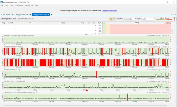

Here's the IPv4 vs IPv6 to Youtube for the same time period.
IPv4
IPv6
- WiderMouthOpen3 years agoEsteemed Contributor II
That certainly shows some kind of issue with IPv6 but how would that effect all your upstream traffic? Surely the speed test your using used IPv4 right? I assume you are going to put the gateway in bridge mode to use your own router.
- Jormungand3 years agoNew Contributor III
IPv4 vs IPv6 to Youtube test. IPv4 was more stable, and maintained a higher overall bitrate. About twice that of IPv6. Meets, didn't constantly freeze and drop to lowest resolutions with IPv4 forced. Either way, my up speeds and stability are cellular level of quality at best.

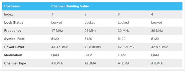

The tech just left. Said levels are fine at the tap, ground block, and gateway. Also, sometime between about 1am and 9am, the upstream greatly improved. Of course I stopped running logs so I have no idea when things changed.
This is my upstream from the gateway. ATDMA
That looks good except there are only 4 channels. Do you have any upstream OFDM channels? If not I bet congestion is a issue. My guess is there was some noise on the upstream that got repair between 1AM and 9AM. So are you better now?
What you see is all the gateway shows for upstream. Just 4 channels, and no OFDM.
It's working fine for now, but I'll have to see if that holds for more than a day or two.
