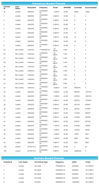

Low Download Speed with Significant Amount of Corrected/Uncorrectables
I have 500 Mbps download, but over the last few weeks, I've been struggling to get 30 Mbps download.  (Upload speeds are where they should be) I'm seeing a significant amount of Corrected and Uncorrectedables and think that is likely what's causing it.  But don't know why there are so many. SnR and Power levels looked good for the locked channels based on what I've read.  (The image above shows the status after rebooting less than 12 hours ago) I replaced my previous modem (replaced with Arris S33) thinking it may be the problem, but it did not solve it.  Next is replacing the coax from the house connection to the modem.  (Direct line to modem, no splitters except for splice at the input.)  Any other ideas or things to troubleshoot before I get a technician out?

    Double check all your cable connections in the home. If your cable wire to the modem connects to a splitter or to a wall connection, replace the cable. IF the cable gets bent, it's ruined. The signal going through the cable is an RF signal, much like the one in your car, and a bent wire can cause the signal to get bounced backwards causing exactly what you have described. ALSO loose connections in the home can allow EMI and RF INTO the wiring, causing the same issue. Verifying all connections are snug, and getting CAPS placed on any wall/cable outlet connections not being used, can in many instances correct the problem, without the need for a technician to come out, and possible a service charge.
  • I replaced the coax from the line into the house and checked that all connections are snug.  There's a splice connection at the drop into the house, but I can't replace that.  Otherwise, it's a straight shot from the drop to the cable modem.  The problem still persists; low download speeds, but upload speeds are fine.  Guess I'm going to have to have a technician out.
