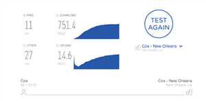

Cox does see see packet loss and slow speeds on their end, I don't feel a constant 1/3 of the upload I pay for is unreasonable, but they don't seem to care
2 techs have came so far, Tech 1 shrugged it off as noise on the line and said a bucket truck needed to come out, Tech 2 saw 5mb upload and packet loss on his handheld, and scheduled a bucket truck to test tap and lines for noise/ingress, both tickets were automatically cancelled due to "ongoing network maintenance in my area", and still has not been looked into
Field Supervisor came out, he ran the Ookla speed test on his phone and saw 940+ mbps down / 35+ mbps (with the biased Cox pathed New Orleans server, while it was storming outside), he looked at everything up to the pedestal, said it should be tested for noise/ingress like tech 2, and planned to do so when he had free time, but weeks later it still has not happened
I ran OBS for the majority of a week set at 6 mbps with nothing else open and it was able to maintain that 99% of the time while reporting my daily results to him
However the speeds still randomly drop back down horrible briefly and recover, and no one can explain why I see hundreds of thousands of uncorrectable codewords across all channels
when running right:
Streaming services on TV display in 4k, PC at 1080p/1440p if available for the content
non Cox biased tests show within reason of the advertised speeds (900+ mbps down / 30+ mbps up)
the Twitch bandwidth test tool shows 7-10 mbps to all servers, 75+ connection quality to all servers
OBS, and Twitch Studio suggest 1080p/720p/60 fps at 6 mbps
when running bad:
the cox biased test will go as low as 300 mbps down 8 mbps up
Any non Cox speed biased test goes as low as 200 mbps down 2 mbps up
the Twitch bandwidth test tool drops to 1-3 mbps results, and 0-30 connection quality
and both software will suggest 480p/30 fps at 1-3 mbps with no game open
I have tested streaming with Youtube when the internet is running bad and also suggest low resolution / frame rate / bandwidth, so it isn't just Twitch
Streaming/Airplay will start drop to a low resolution on TV and PC some times sending pictures and video are slow, regardless of what service and devices
