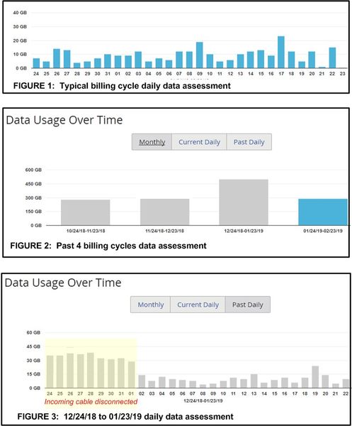

After reading the numerous accounts of unexplained quantum leaps in Cox data assessments, I have become diligent and regularly check my daily and weekly metered usage on Cox.com.  Over the past year, the Cox meter says I typically use just under 300GB each month and the weekly pattern is consistently uniform.  Refer to Figure 1 and Figure 2 in the linked JPG image:

These are screenshots of my data usage graphs copied from my account information on the Cox web site.  The weekly pattern corresponds to my usual internet habits and the claimed data consumption is similar to a rough estimate.  So I think Cox claims regarding the accuracy of the data meter do have merit.
This Fall and Winter, however, there were some strange anomalies, though I still have not come anywhere near the 1TB cap.  During November, a windstorm toppled a tree that severed the power line to my entire street.  We lost electrical service for 36 hours while the affected pole and wires were replaced by the utility.  Naturally, I expected the data consumption meter to show at least one day with zero use.  But the graph for that week was virtually identical to the weeks before and after the incident, which was curious.  Perhaps, I theorized, Cox is able to power the phone modem and cable modem by supping DC over the cable, similar to my outdoor antenna amplifier, so data continues to flow despite lack of electrical service.
Between Christmas and New Years we traveled completely across the country to spend the holiday with relatives.  Since no one would be at home to use the internet, I not only switched off power to the modem and router, but also completely disconnected the incoming cable (for 10 days) while we were away.  What resulted was completely the opposite of what I expected; according to the Cox data meter, daily data consumption during those 10 days was much higher than normal, and did not match the usual weekly pattern.  Once the cable connection was restored on January 2 , the historic consumption pattern magically returned.  Refer to Figure 3 in the linked JPG image for a labeled screenshot.
Had I left town for a month instead of 10 days, I would have exceeded the data cap without actually using a single Byte of data..
