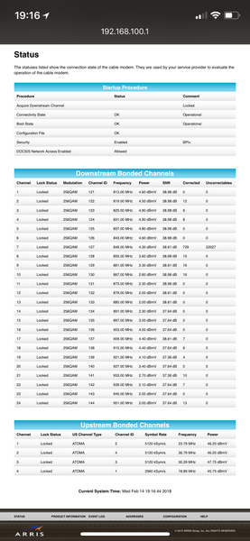

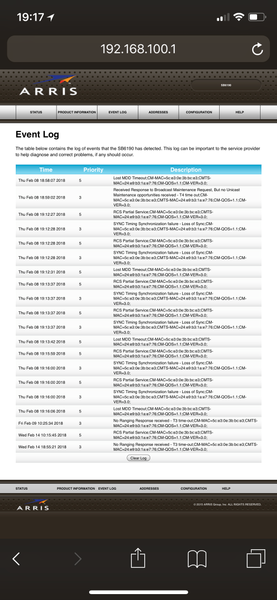

For the past month I have been having high ping rates on Xbox and buffering in Netflix.  Checking my speed from several websites and locations speed rarely goes over 150mMbps. I currently subscribe to the ultimate package.  I have called support with minimal changes to status.  I believe my connection lines outside the home could be the cause.  Any recommendations would be great.
these are my modem status from today after a reset and the 27th after a week of up time.
16 Replies
  • Hello sokal48, The modem does still appear to display some signal issues that can deteriorate the cable connection and would recommend sending a tech out to take a deeper dive into the issue. Please reach us on Twitter at @CoxHelp, visit us on Facebook, or email by at cox.help@cox.com when available. Provide us the name on the account with the full service address with a link to this thread so we can assist with scheduling a visit to the home.

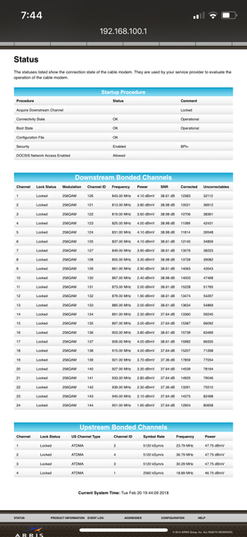

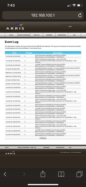

    A Tech came out and was very helpful. ran a bunch of test and added a power reducer to lower my power. he test all my lines and all were in good shape.  Net worked well for a few days now, until today.....  back to intermittent connections, web pages time out like dial up slow at page loading.  i also seem to be getting disconnected enough to have some uncorrectable again.  The tech was to send a Main line Tech to check the power lines.  I believe that the Gloucester point, VA area is having a major connection issue.  Please find and fix this issue.
  • sokal48,
    If maintenance has adjusted signal on the lines we might need to tweak signal at the home. I'd like to schedule another appointment. Please email me at cox.help@cox.com so we can get you set up.
  • sokal48's avatar
    sokal48
    there has to be an issue that still need to be fixed or looked in to.  I know i'm not the only one with speed and latency issues in my area.  The service of 300Mbps up and 30Mbps is what i pay for.  Should be able to stream netflix or play online games with no issue.  this was my modem readings today. Seems that every few days is something going on.
