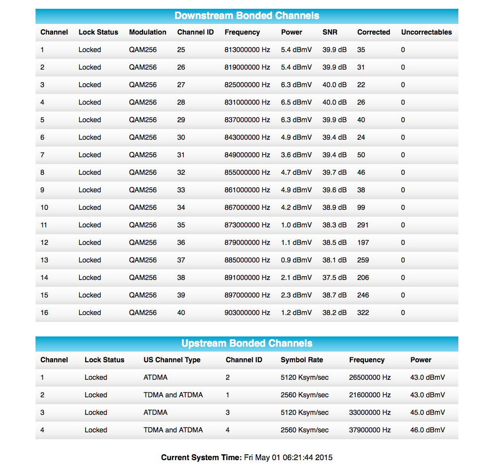

Before today, I was running 8 channels down and 4 channels up with speeds 150mbps. This mirrored the ultimate plan I have.
Today, I have 16 down and 4 up with speeds of 20mbps and below. This is terrible! Can someone please fix?

Seems to be better this morning. Should I be concerned with the high corrected numbers?

Nope. Problem still exists. Only at night does the speed take a terrific nose dive. 10Mbps compared to the 160Mbps earlier in the day. Every night to slows to a halt since I've noticed the change in the number of channels the modem is bonding.
I worried about the number of corrected. It was never this bad in the past.
I need a stable fast internet connection. Please fix.

Can you tell if my firmware was update recently? Again this problem only happens at night. Tonight I noticed it at 7:00pm. It slows to a crawl. In the morning, it will be fine. This happen shortly after getting 16 channel bonding with this modem. It was working fine prior with 8 channel bonding. Is there an issue with this new firmware? I see other reports of slowness on this forum with the same modem.
Do have to buy an other modem to fix this issue???

The firmware appears to be current on the modem. I think having a tech come out and take a look would be the next best step to take to resolve this.

Looking from this end the modem does appear to be reporting upstream signal issues. You could try bypassing any splitters you have on your cable lines to see if that helps. Having a tech come out would be a good idea.
