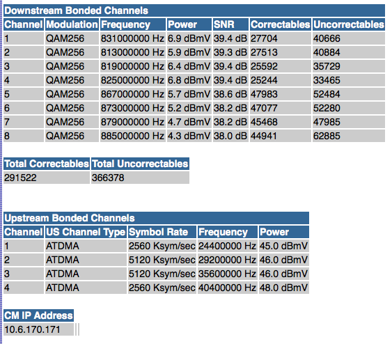

8 Messages
Also seeing substantial uncorrectables on the modem, less than two hours after reboot:
1 Attachment

@macwhiz
I took a look at the modem from here however nothing appears out of the ordinary at this time.  Are you still experiencing any problems?
8 Messages
@ChrisL: Yes, I'm still seeing massive latency spikes. As best I can tell from traceroutes, they're occurring close to me network-wise. If I ping the first hop in my traceroute (local node? hubsite?) I'm seeing the issue:

--- 10.4.56.1 ping statistics ---
10 packets transmitted, 9 packets received, 10.0% packet loss
round-trip min/avg/max/stddev = 8.898/256.822/982.096/370.589 ms
Same story with almost any destination IP. Ping times spiking up over one second. NTP can't get a solid lock, there's too much jitter in the latency to keep good time. Online games like Diablo III are unplayable. VoIP is unusable.
By the way: I've noticed my modem occasionally spiking its upstream power over 50 dBmV; I understand that's out-of-spec for DOCSIS 3.0. My drop is underground RG-11 installed less than two years ago. It runs to one Cox-installed amplifier; one leg of the amp output goes to the modem (via the power inserter). The other leg goes to the TVs.
We've had a lot of outages lately. Does Cox need to replace some equipment in this area or something?
Outage: Feb 24 2015 00:40:22 EST
Outage: Mar  9 2015 00:37:12 EDT
Outage: Mar 13 2015 01:00:12 EDT
Outage: Mar 15 2015 22:37:12 EDT
Outage: Mar 16 2015 01:35:12 EDT
The fact that this issue started after the most recent Sunday/Monday outages seems suspicious.
Former Moderator
7.1K Messages
I checked again and I'm still not seeing any loss or abnormal latency between us and the modem.  Can you try connecting a different device directly to the modem and testing again? -Chris
