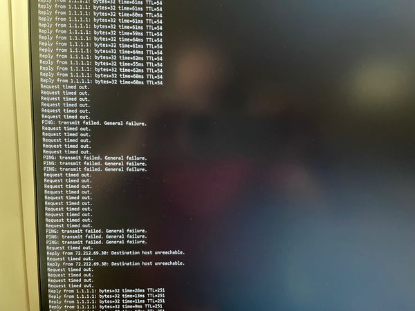

Intermittent connectivity loss
I'm writing this out and am at my wits end..
I've been facing multiple instances per day with complete packet loss sometimes for up to a minute, for the last few weeks. I've had multiple service tickets via chat with all of them ending in the tech at the other end rebooting the modem, telling me everything is okay or making an offer to have a technician sent over for a fee (when clearly the issue is on the Cox-end of things - a continuous ping I have running clearly shows a Cox router: 72.212.69.30 returning a 'Host unreachable'.
Any advice on how I can get this resolved? Both my fiance and I work from home and losing connectivity multiple times every day during video calls is unacceptably frustrating.

    Had another instance of packet loss yesterday evening and the ping results showed the same issue: bunch of lost packets followed by a few where a Cox mailto:router@72.212.69.30 responds with a host unreachable message. I don't believe the issue is a physical layer (Ethernet, WiFi) issue due to the fact that my pings appear to be reaching this router on the Cox network.

      One thing to remember, a ping is a very low level request, if the device you are pinging is busy, it may not respond.
      With that being said. just a bit of verification. Have you tried swapping your cable wire with a new one, replacing barrel connectors in wall plates, and any splitters you may have? Also, verify all cable connections are snug, they can become loose even after being tightened, due to vibrations.  If everything is good, all lights on modem remain solid, then you may need to call Cox and request a technician. Remember if it is an issue with home wiring or your equipment, there may be a service charge unless you have Cox Complete Care. IF the issue is on Cox's end, all repairs are at no charge.

        Fair point on ping traffic and servers rejecting it - which is where you'd see a 'Request timed out'. But the fact that during each drop out there's instances where 72.212.69.30 (which if you do a reverse lookup, is a device on the Cox network - presumably a router) returns a 'Host unreachable' shows that there is a problem on Cox's end.
        I get that this level of technical analysis is expensive and Cox would rather work their way up, but blaming stuff on wiring or WiFi in the face of data is frustrating.

    What modem / router are you using? Is your computer connected via ethernet, or WiFi? When you temporarily lose your ping packets, do the lights on the modem change in any way? Need some info to help troubleshoot.

    Are you having the issue on all devices or just that device because a general failure points to a device issue, if google is to be believed. Also, wifi vs wired? Last, post a tracert or pingplotter result to same server to see where it's failing. Like where that host is.

      Beengolfn3, in my case the tech came over and within a few minutes, took out a splitter that was in-place from the original Cox installation. We didn't really need one since we aren't planning to use cable services etc.
      And since then, we haven't had any mini-outages and the packet loss is no longer an issue either (I've been keeping an eye using the continuous ping).
      What are you seeing when you run a constant ping to 1.1.1.1 (Cloudflare's DNS server doesn't seem to have a problem with ping traffic unlike Google's 8.8.8.8 which drops some traffic)?

        If you don't have TV service why was splitter there to begin with? Did you have TV service before? Is this a new install? Was it a self install or pro install. Guess it doesn't really matter since my gut is telling me it's some kind of device issue, probably NIC driver related. But that is without knowing if it happens on other devices.
