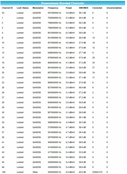

Now to today.. I'm back to being unable to access my network. The connection is dropping completely out at times or slowing to a crawl for a bit. These timeframes coincide with spikes in error rates in the thousands for each channel (not terribly bad), but with the 903, 909, and 927 bands climbing into the millions again in a few seconds. Power levels were WAY higher than they had been (8.5-11 dBmV) with SNR ratios looking higher, but then after the problems started I got a ton of SYNC errors, T3/T4 errors, Range Window Violations - and then when I could finally access everything again, my power levels were back down to the 3-6.5 dBmV range and SNR ratios had dropped a bit (about an average of 2 entire points across the board).
I've been doing some closer looks as today progressed and noticed the replacement modem from the techs is hardware v4 (previous was v6), and that the FW version is downgraded as well. Causing possible problems? What version of FW is Cox officially running for the SB8200?
If anyone would like some readouts from the modem, some past readouts I've kept since the problems began, pics of the wiring, etc - just let me know. I'd be happy to post them here. Any insight would be great. I'm basically at a loss. Signals look amazing from everything but these 8200 modems. Just weird that everything was good before the D3.1 flip, then it got all funky again afterward.

    widermouthopen Just wanted to update you. Had the visit from the "Network Specialist" today. As listed on his card, he's a 'Field Technical Specialist'. Really knew his stuff. He mentioned the fact that the old cable is severely out of date and is known for getting corrosion on the insides of the coax line. It's not UV protected, so I guess this breaks down the outer layers and allows things to corrode.
    I guess he's the guy that gets called in when other techs didn't/aren't able to get the job done. He decided to run new line and clean up the cabling outside even further. Instead of running double splitter, he ran a 3-way with one line to each apartment. Ran new lines for the apartments that needed it. Good lord the signals are so clean now.

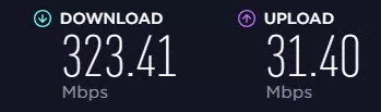

    Here's my speeds now:
    It's not much, but I bumped from getting a range of 270-300Mbps down with around 27 to maybe hitting just at 30 to these speeds solid on each test I run (varying servers and sites). Solid speeds that ramp up the flows much faster than before as well.
    The signals are great. I'll post that at the end for you as well. Guy really knew his stuff and made sure that everything was looked at. Even installed a new faceplate for the coax connection just in case, haha. I'm signed up for some monitoring program now so that they'll have a stream of data for analytics and stuff directly from my modem. If it goes offline or if speeds drop past a certain point (or any other problems), then it'll send him an alert directly - so that's cool.
    We'll see how things perform over the next couple days, but I'm pretty sure the problem has been fixed. He cut open a line for me, and it definitely looked nasty. Definitely most, if not all, of the problem that I was experiencing.
