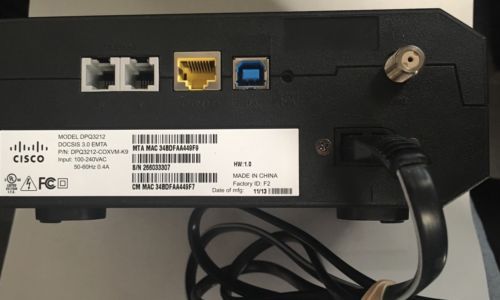

    Grymwulf:  Thanks for your response.  Based on what I read and your E-mail, I will purchase a new router.  As I was preplanning what I was going to do, I looked at your recommendation; "using the DPQ3212 for data, remove the splitter and hook the router to the Cisco modem.  You then call in to have your data service transferred to the Cisco modem. "
    IMY set up is a s follows:  Coaxial cable out of the wall to a splitter:  From the splitter one of the coaxial cable connects into the Cisco Modem DPQ3212, from the Cisco Modem a phone cable goes to the phone.   The second coaxial cable out of the splitter goes into the Arris Surfboard SBG 6580.
    However, if I remove the splitter and looking at my Cisco Modem, I can't see how I would get a coaxial cable from the Modem to my new Router?  Or do I connect from the Cisco Modem to the new router via a coaxial cable?

    The coax doesn't go to the router - your Cisco modem should have an ethernet port on it, that is the cable to use to go to your router.  The yellow plug on this image is where the router plugs into.  *** Google search Image ****

    @NelsonE, just make sure you get a router (like the R7000 both @Grymwulf & I recommend), not a gateway (combo modem/router, like the SBG6580 you have).  A stand-a-lone router will only have a RJ-45 Ethernet connection, not a cable connection.
    The R7000 has 5 RJ-45 ports, a WAN port that connects to the Ethernet port of you Cisco Modem, use CAT-5e or CAT-6 Ethernet cable.  The other 4 ports are LAN ports and can be used to connect wired devices to the network.
