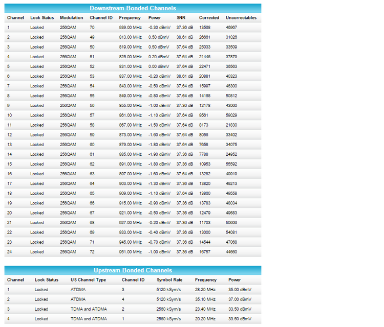

Below I'll post all relevant data I can think of.  Any assistance is greatly appreciated but I'm very skeptical that anything can be done here.  I'm nearly positive this is a hardware issue outside of my home that will require a field technician, but I know you have to start somewhere.

    From this end everything looks good with the modem status.  Can you try signing into your http://www.cox.com account and running some speed tests there both with and without the router?

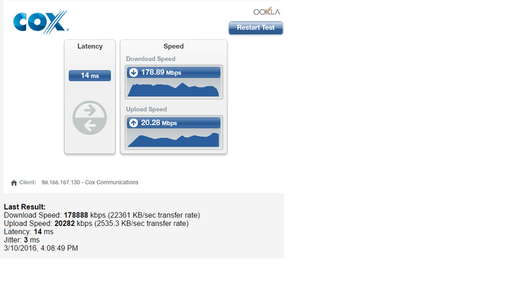

    Thank you for your reply and help, I can do those tests when I get home.  However, the Cox speed test and the speedtest.net seem to give me false results.  I can test on those sites and I'll get from 16-20 Mbps yet I can instantly try a testmy.net or speedof.me and get the usual 2-3 Mbps upload speeds.  This is then further confirmed by the Xbox one connection test that shows an upload speed consistent with the latter (slower) sites.
    Again, it's the real world experience that doesn't coincide with the readings on those sites.  My Plex server can't stream media to my work computer faster than 3'ish Mbps.  I can't upload videos to Youtube or transfer files between work/home any faster either.  Then my Xbox connection test shows me getting less than 25% of my expected speeds.
    I've done all these tests bypassing the router and with it attached but nothing changed.  I've read that the speedtest.net and Cox's (hosted by the same owner as speedtest.net) can be given higher priority traffic and will read out higher than the real world speeds being received.  I honestly don't care how fast those sites say I'm capable of uploading if in reality I'm not even achieving a quarter of that.

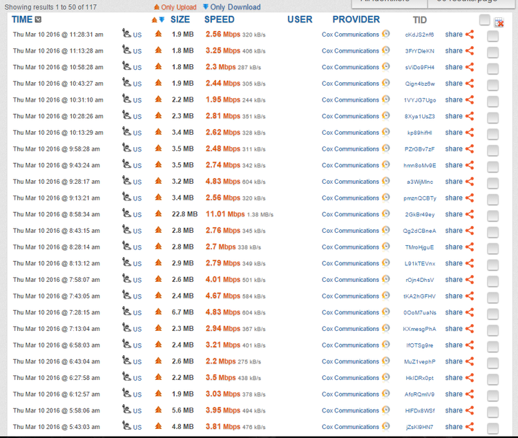

    I should be home in a few hours and will upload those sites tests with and without the router.  I should be able to also show the test history to show that even though they will more often achieve the 20 Mbps, they still test well under 10-12 Mbps the majority of the time.

    With the router:

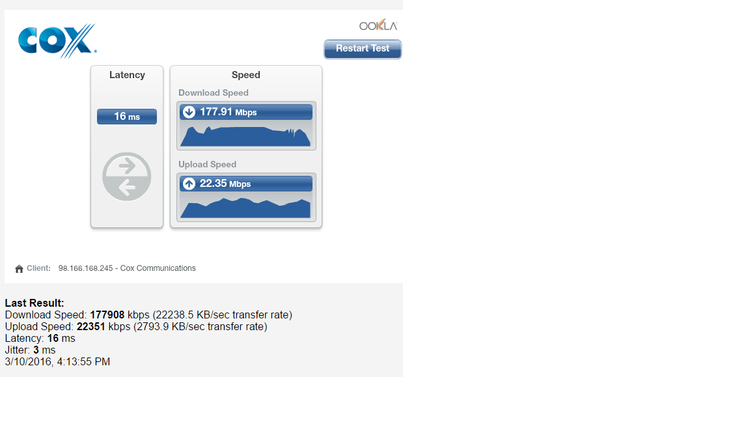

    And now bypassing the router:
    An extra, still bypassing router:

    However, all of these were taken within minutes of the above tests.

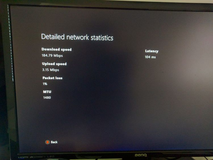

    And here is a picture of the Xbox one detailed network statistics:
    Then after doing all of these I did another speedtest.net just to confirm it would continue to give me false readings.
    In practical use, I never get 15 Mb/s.  If that were the case I would be able to game on my Xbox one and stream the video online without suffering any loss in quality and without lagging in game.  I would be able to stream media via Plex faster than 2 Mb/s from my home computer.
