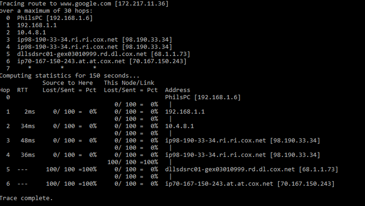

During the week my normal speeds on ultimate test as ~330/30. After 7:30pm on weekdays and from friday to sunday night, its common to see less than 100mb down, the upload remains unaffected.
To be honest the download speed wouldnt bother me if that much were the only problem. The main issue im having with these slowdowns is ping related. Online gaming just isnt enjoyable during the times I stated.
Normal modem stats:
Modem stats during the issues:
Pathping to a Rocket League US East server:
Pathping to google:
Pinging the RocketLeague server at night: https://pastebin.com/M8M8p6Rj

    The modem is reporting a high amount of power adjustments. Is the modem plugged up to a power strip or signal amp?

    Cox technician installed an amp last year.

    Cycling the amp did not help. Checking all connections didnt help. I bypassed the amp, and that didnt help either.
    As far as I can tell its something beyond the outlet on my wall that is the problem.
