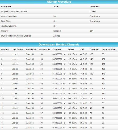

I had a very old modem (it was free from Cox years ago) and upgraded to a Arris SB6183 in April. Had some connectivity issues and bought a D-Link DIR-890 Wireless router in July thinking that would help too. Ever since then I have had nothing but troubles. My old modem might have been slower, but it stayed connected. What tests can I do to determine the issue? This is the status page of my modem.

    None of the downstream signals look bad, SNR is very high, power is very good, right close to 0.  I don't see the upstream signals, that is usually a cause of frequent disconnects.
    Also, can you look or copy/paste the log information?  That usually will tell us why it is disconnecting, or what is happening right before you power cycle it.  At this point, I can't determine which is more likely, modem or router triggering of your issue.  Heck I just had an issue with wireless drivers for a realtek wifi adapter that was disconnecting 3 to 4 times an hour, but the rest of the devices weren't suffering the same issue.  (Stupid Windows 10 updates)

    Your TX values are too high - usually you want 50 or lower, up to 52 with certain modems works...
    SYNC/T3 issues will pop up when TX is too high, it basically means that your modem is 'yelling' and not being heard clearly.
    Check connectors/reseat connectors on the coax - if your modem is on a splitter try to bypass it.  If you've got an attenuator or filter on the line, try removing that as well.  All else fails, this is usually something that an on-site technician can check.  But check your wiring/connectors first, if it's something there you can usually fix it faster.
