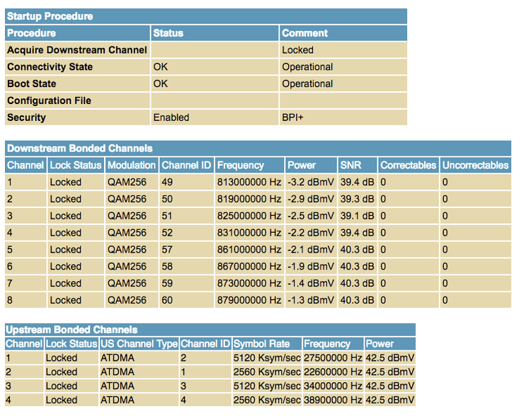

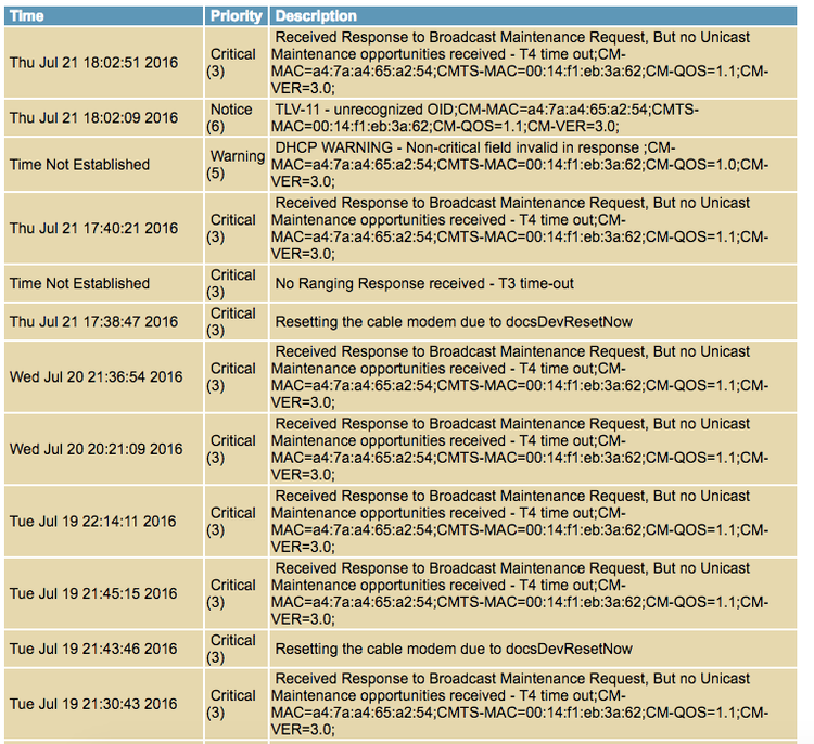

    The modem's signal looks good for up and down stream levels. While the log does show a few T4 time outs typical they are just tied to a signal adjustment as long as they are not constant would not be tied to a speed issue. On thing the router side of the Gateway is showing is varying speeds on ethernet ports. Are you seeing the speed issues on specific computers/devices or is it effecting everything that is connected?
