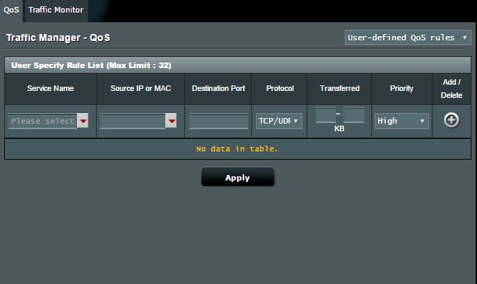

On the router there are QoS setting which I enabled.
Then there is another page with Individual settings and I can select his Roku box by MAC address and it fills in the port and stuff. The heading looks like this
Service Name
Source IP or MAC
Destination Port
Protocol
Transferred
PriorityAdd / Delet
Under the transferred heading there are 2 boxes with a squiggly line between them ~ so box ~ box in KB
Any suggestions as to what figures to put in there to limit him? And if you could also explain it to me I would be most appreciative.

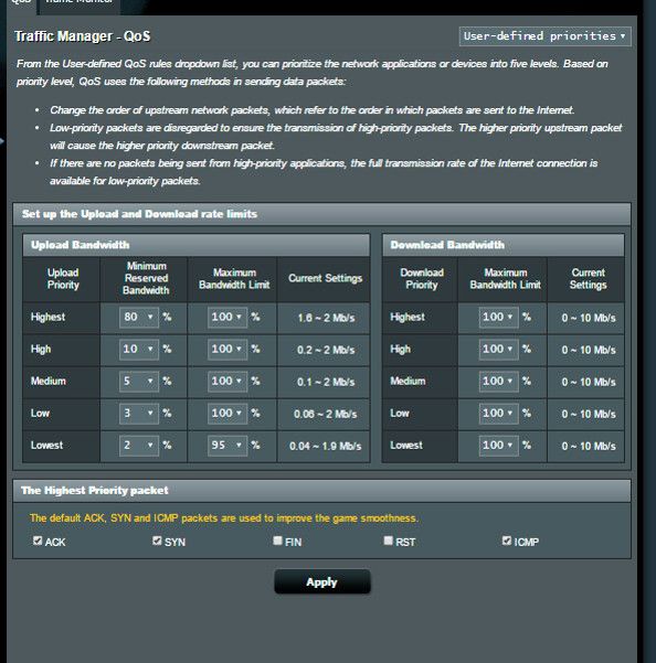

    User defined QoS Rules - I can seem to insert the rules screen shot - headings below
    Service Name   Source IP or MAC  Destination Port  Protocol  Transferred  Priority Add / Delet
    User defined priorities Screenshot below
    This is beyond my scope - but I am trying to understand and learn - I thought that I would somehow define the rule - like his Roku that I want to limit and then go to priorities and assign it with an appropriate % of bandwidth/priority and that somehow if I can get the right number that it would limit his traffic to no more than 1 (or 2) gig an hour.
    Is that possible with this setup
    Any suggestions - and if so I really need help figuring out the numbers - once I have a baseline with an explanation then I can try to figure out the rest.
    I cannot even attach the screenshot - what is going here. The screenshot keeps disappearing and that is the important part to show you so I attached it an another post.
    Thank-you much!

    You can't limit a devices bandwidth with this version of the firmware.  Traditional QoS on ASUSWRT does not limit bandwidth ... as is says on the User-defined priorities screen: "If there are no packets being sent from high-priority applications, the full transmission rate of the Internet connection is available for low-priority packets."  Unfortunately, upgrading to newer firmware of installing an open source system like dd-wrt are not possible so, IFAIK, you can't do what you want with your current router.
    Actually, I'm not 100% sure what you are trying to accomplish.  You say limit is streaming to 1 to 2GB per hour, that can be done in multiple ways.  Limit his bandwidth (his Mbps) so an hour of streaming doesn't use more than a preset amount of data (1 or 2GB).  Of limit his usage, allow him full bandwidth and shut him off after a preset amount of data.  Either case, I'm not sure you really have a problem.  Netflix recommends 5Mbps for full HD streaming.  5Mbps will use 2.2GB per hour.  So, unless he is streaming in Ultra HD (requires 25Mbps), a single stream on his Roku won't use much more than that 2GB per hour anyway.  Could you be looking for a solution for a non-problem or is he doing something else too, hogging the bandwidth?
