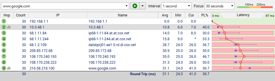

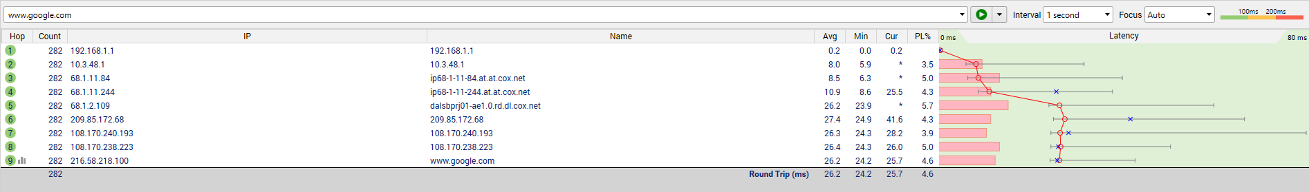

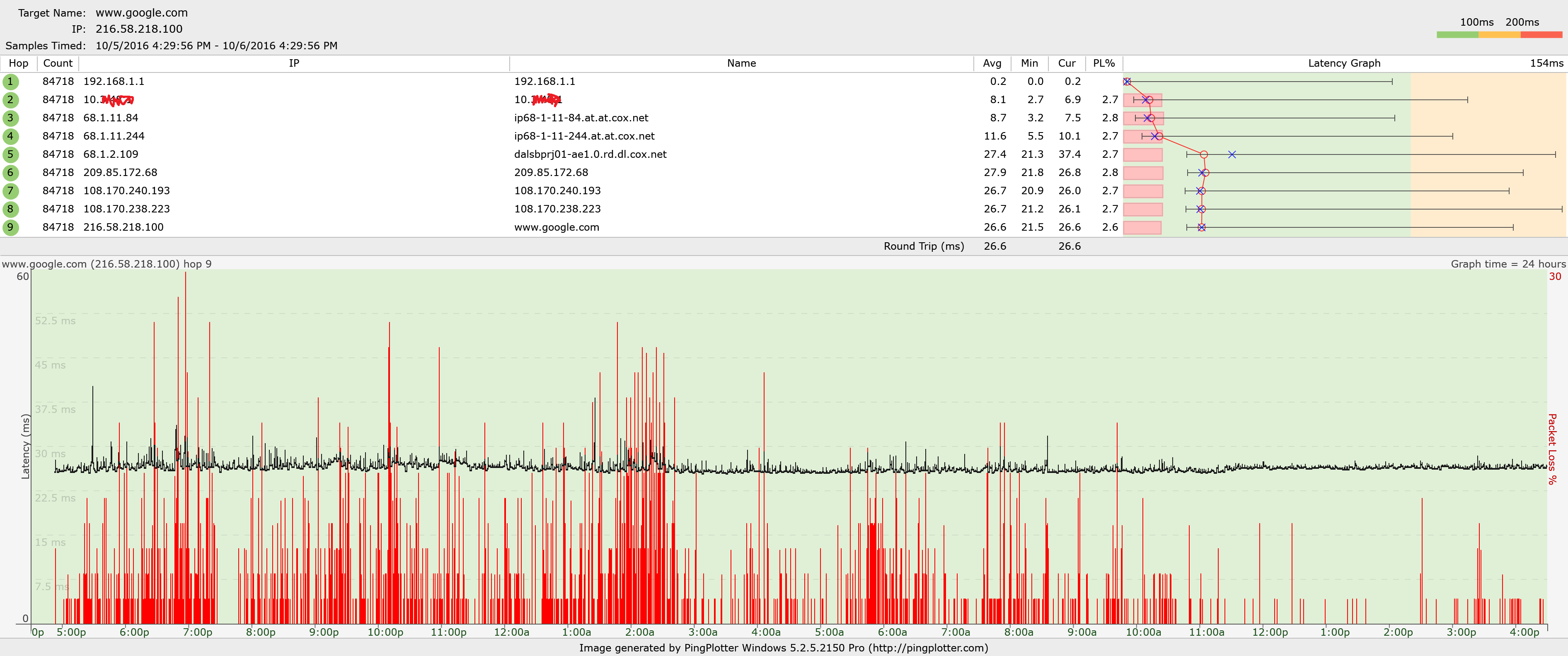

    I have been running a Pingplotter test to google.com for a day and a half now and it looks as if I'm getting packet loss pretty steady throughout the day. It does get worse during peak hours though for sure. The loss starts happening at what I assume is my local node IP 10.x.x.x. I will post the ping plotter once I get home from work and also some tracerts. My speeds say they are good most of the time but if I get a test result during one of these spikes then my upload is horrendous like 200 kbps horrendous.

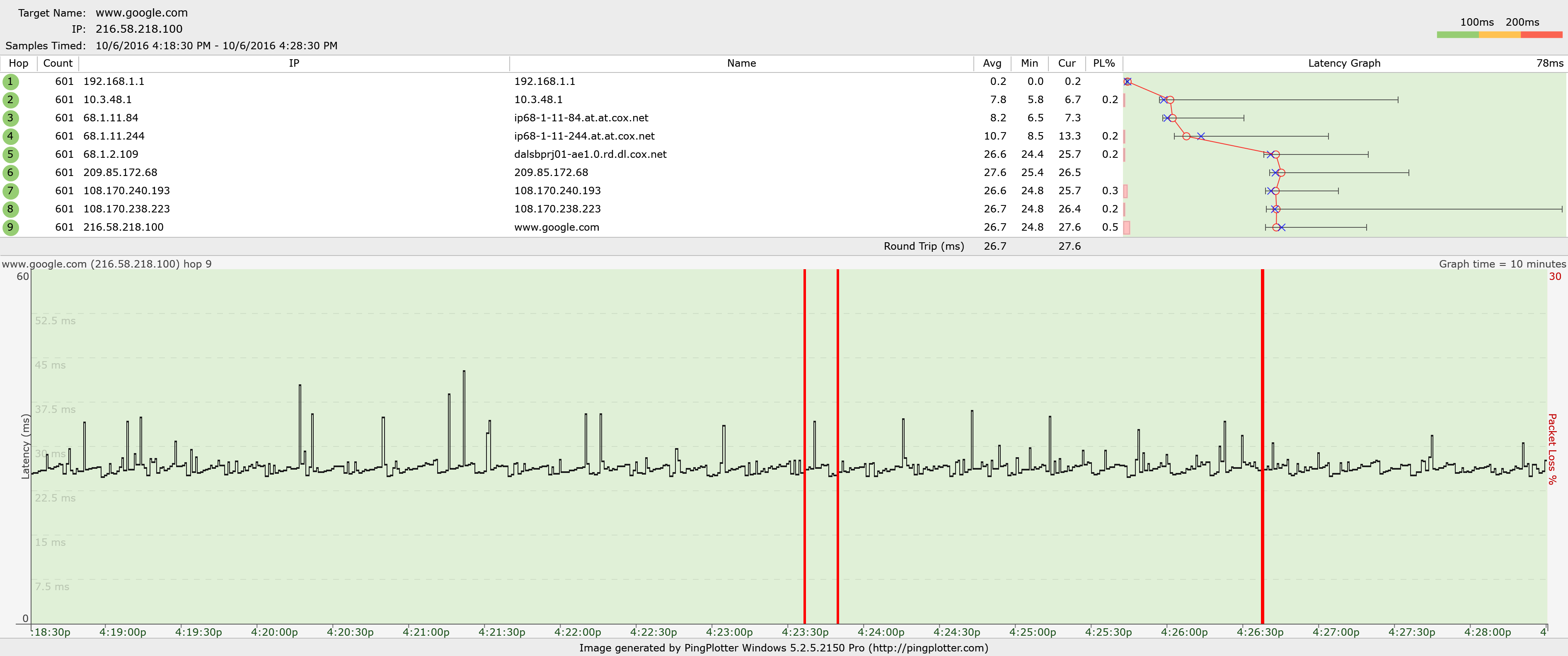

    Yes all the typical things that are affected by intermittent connection/incomplete connections. Here is all the data I have put together so far.
    24 Hr Snapshot
    https://i.gyazo.com/eb049570b9d4c1758de9a3256262331c.png

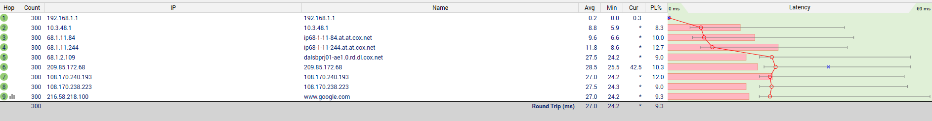

    This is before peak hours. Still some packet loss with no other devices on or connected.
    https://i.gyazo.com/830f58091f505ad0064925adbfee4afe.png

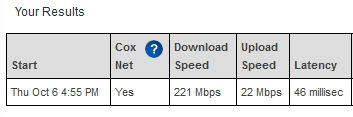

    Here is the speedtest you wanted me to run(which of course is fine currently)
    https://i.gyazo.com/8db53ea63af0508c13cd42382e021475.png
    Here is a tracert to google from cmd prompt
    https://i.gyazo.com/62cb8c038dd2c0ba94f37f2b28ea176c.png
    Here is a 30 second snapshot of +40% Packet Loss over 30 seconds
    https://i.gyazo.com/2552fccac29e3c7bcd16889879964abe.png

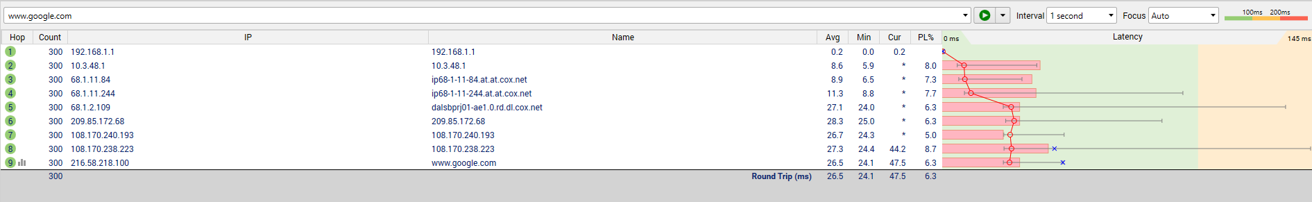

    Alot of the results timeframes looked like this. An asterisk indicates a timeout? Not really sure.
    https://i.gyazo.com/ad7e3cc5ea09414bca438a8e5eae14d6.png
    https://i.gyazo.com/2a75880584d0fe638b2bdc29efa319ba.png

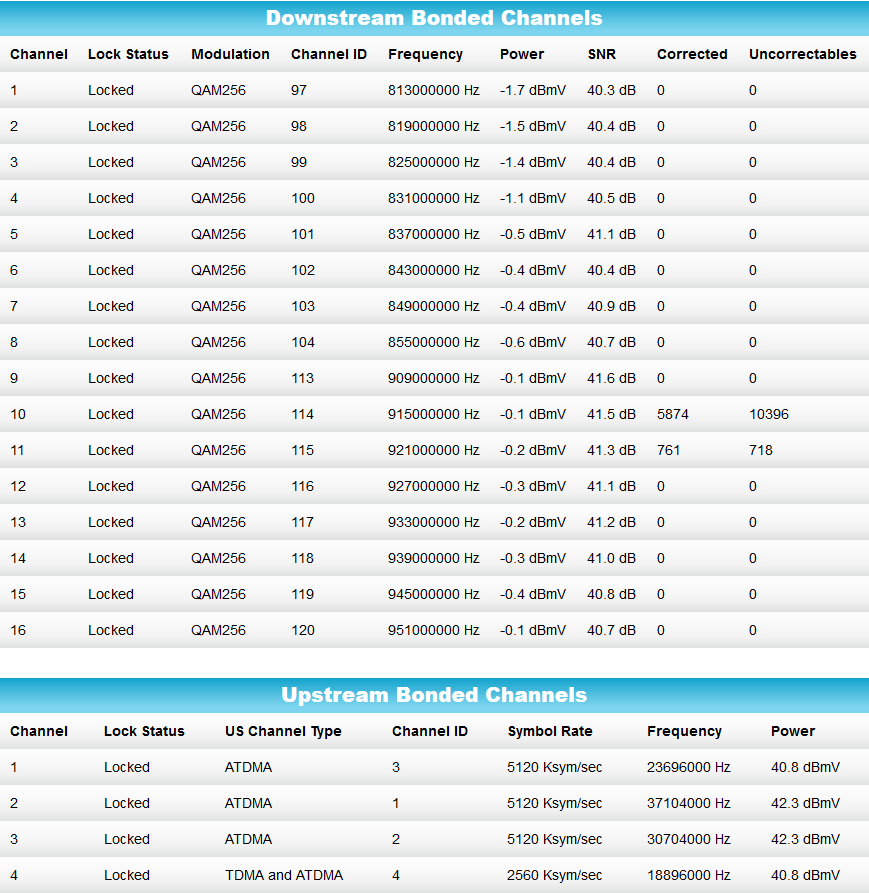

    And finally my Modem Power Levels & SNR
    https://i.gyazo.com/0f2d708eab094fa3b51ff8617d9dfc96.png

    A few T3/T4 errors are quite a common occurrence. So long as they aren't happening frequently and one after another they are usually unnoticed. It sounds like you may have figured out the primary cause of the issue at least. Should anything else come up let us know.
