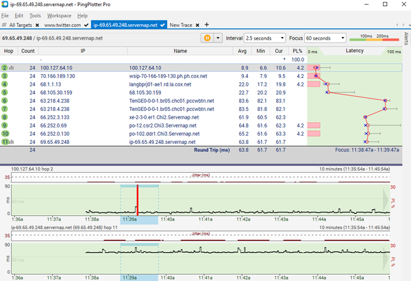

    I won't be able to test directly connected to the modem until later tonight. However, I installed ping plotter and have been trying to learn how to use it. From what I see, most of the packet loss seems to begin around hop 3 for the majority of my packet loss:
    Thoughts?

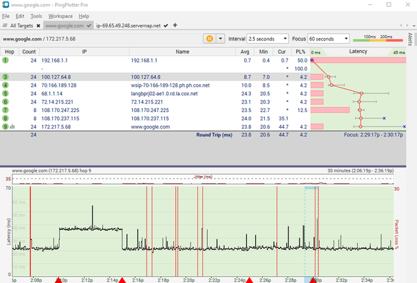

    I'm actually more concerned that pingplotter is showing packet loss at 192.168.1.1. Can you try that test again without the router?
  • Wecomewego's avatar
    Wecomewego
    This is expected behavior for some routers with how the handle ICMP requests per Pingplotter and does not occur on every test I have run. I can only run a longer duration test without my router after 6PM as I need it for my work's VPN during the workday.  However, as I mentioned I have tried testing hard wired directly into the modem previously and still experienced the same behavior and do not believe the router to be the root cause.

    Yes that is correct, it's called ICMP deprioritization however I'm concerned that it's showing up on 192.168.1.1. Do you have ICMP deprioritization on your home router?
    Wecomewego
    Chris,
    I'm not sure, I haven't changed any advanced settings on my router and I don't use QoS. While typing this up, I had a huge packet loss spike that I noticed when using VOIP. Pingplotter shows the same results for all 3 tests I'm running, that packet loss begins at hop 3.

    This result looks different than before. The original result you posted showed 50% packet loss at the Netgear router before reaching the modem. I'd definitely try getting some more results without the router so we can compare.

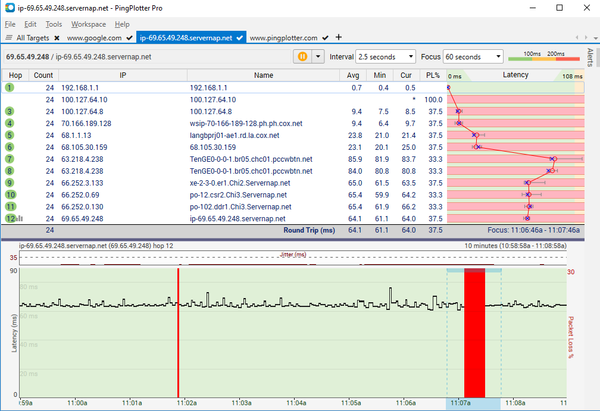

    I think it was showing 50% loss because it was timing out every other 2.5 second interval. If I moved the interval to say 5 seconds or maybe 1 second, there was no loss. I wasn't able to get a larger sample size since I connected during my break, but here's showing the packet loss at the same hop when connected directly to the modem.
