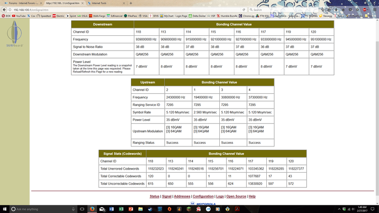

I had issues with my internet being really slow.
My modem was showing a very high (in the millions after a day) of uncorrectable codewords on just one channel. I suspected that was why the internet would ** out after a few minutes from the buildup of these codewords. We had a guy come out and said our modem is probably bad.
So we go out and buy the same modem (docsis 3.0 btw) and the problem was resolved. It is now two months later and we are experiencing the same exact issue all of a sudden. Can the modem go bad this quickly???

    After I reset the modem and plugged in directly, using the Cox speed test:
    92.81 Mbps Download
    12.07 Mbps Upload
    After about 15 mins:
    20 Mbps Download
    12 Mbps Upload
  • currytl's avatar
    currytl
    Looks like the slow speeds are correlated to the high number of uncorrectable codewords on channel 117.

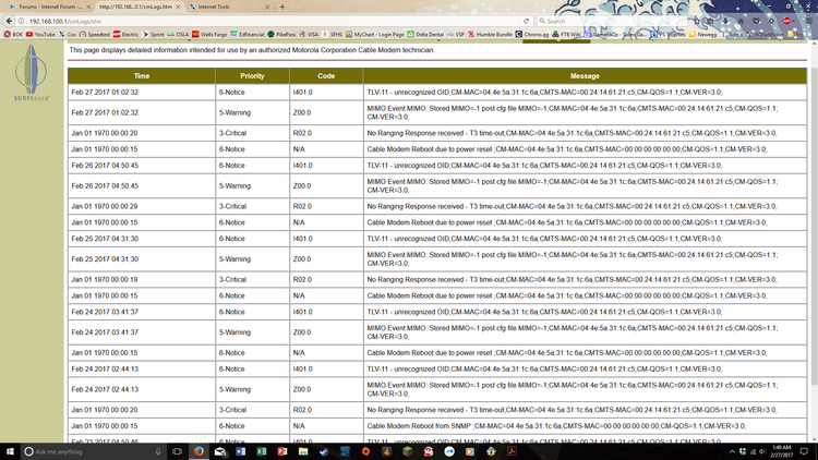

    Also there seems to be a T3 Time out on the logs whenever I power cycle the modem.
