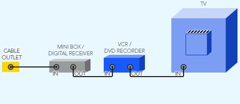

Minibox instructions do not show how to hook up with my existing DVR.
 How do you hook up the DVR to record now that the cable connection goes into the minibox?  Do I need another connection?  Please advise.

  • Hi Lvfaz,
    If you are referring to a personal DVD-recorder used like a VCR, use the below picture for reference when connecting the mini-box:
    Does this help?

  • AllenP's avatar
    AllenP
    Valued Contributor
    What DVR are you using?  If it's a Cox DVR or one that supports a cable card, like Tivo (other than series 2), no minibox is needed.  Otherwise, coax analog output of the minibox to coax input of the DVR.  The DVR must be set at the same channel as the switch on the minibox (3 or 4) and the minibox used to tune channels.
