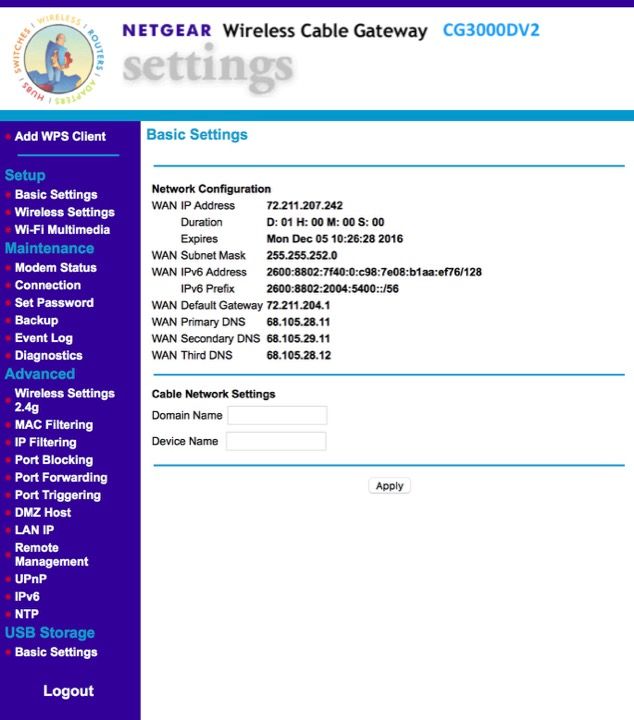

  • Techno - I appreciate the help....Yes, I had gone over the list of policy blocked ports with Cox earlier to make sure there was nothing blocked that they knew about. So my statement was more related to a non-policy block of the port.
    I would like to implement your suggestion but the manual you reference doesn't look anything like my router interface and I'm stumped about how to find the features you mention. Here's my interface as a screen shot.
    I tried to find the features you mention and can't find them. I know this manual says it for my modem but there must be something different? Maybe the software version - I know there might be a newer version - mine is V1.03.03.
  • Looks like that section on Content Blocking was related to V1.02. It appears to be gone now. Not sure what that means.
