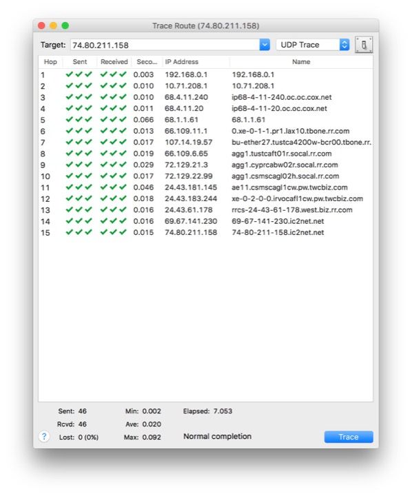

This is familiar problem returned. There is now a server showing up between my home and my offsite server that is causing unacceptable latency problems.
The IP "192..." is my router at home and the IP "74..." is my offsite server about 5 miles from my home. The server IP "68.1.0.242" is the problem.
It's a cox network server that is introducing latency that affects my timeouts when I try to reach my offsite server. My server is hosted at IC2 - a hosting service who has looked at my latency problem before and concluded the same thing when pinging the network from IC2 to my home.

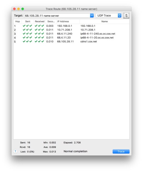

To illustrate that point, here is a trace route to my Cox Name Server.
Illustrated here is a ping going out and back to my Cox Name Server whereas my modem presents only 3ms of latency using my wireless gigabit network connection and the first Cox server I hit is only 11ms of latency total and the name server is of course IP 68.105.28.11 with a very low latency.
  • Really no help on this forum and no help from Cox Support. The problem was fixed when someone noticed the issue and changed the server routing. See the difference.
    Now I have 15ms end to end with my server across town and this is how it has been for many years using Cox as the carrier. Now everyone thinks that that 96ms end to end is not a significant issue with bandwidth but I'm hear to tell you that 6.4X the latency is 6.4 less bandwidth and it shows up as long load times, long search times on my offsite server. It is not the service I signed up for.

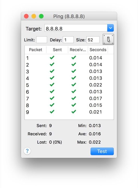

    From your issue with a .07 second (70ms) increase in pings I'm betting you are talking about communicating with a game server.  It could be mumble/TS3 but I've not seen ping be that big of an issue at that low level.  Normally I've never seen anyone have an issue with that low latency, but hey to each their own.
    Do us a favor, check the ping to 8.8.8.8 and 8.8.4.4 to see if your path goes through the same router.  It is suspicious that this router does seem to introduce more delay than all the others combined, that does normally indicate too high of a load, or improper load balancing.  That could do more than increase the latency, it could lead to dropped packets which would affect gaming much more than a 70ms latency.

    Here is the current up to date trace route.
    2ms through my router doesn't look like a problem to me. Right now this is a wireless connection. The next jump is to a IP 10. number and that's the first server in the outside world - 13ms is not an issue to me. But when I get to 68.0.1.242, now I see the big latency jump. And the next one adds another 20ms.

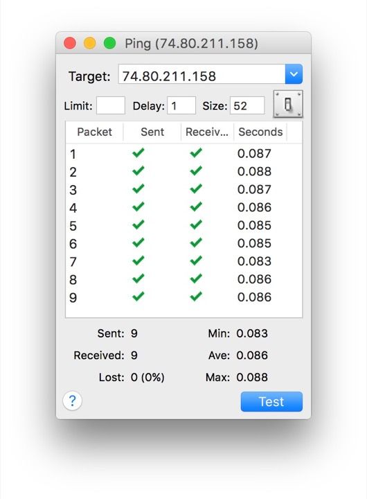

    Here is the ping you asked about for 8.8.8.8 and following is the second 8.8.4.4
    and here is the ping to the server which is about 5 miles away.

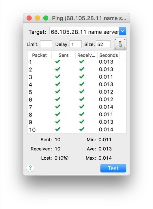

    and here is the ping to the Cox Name Server for reference - all of these look fine to me.
