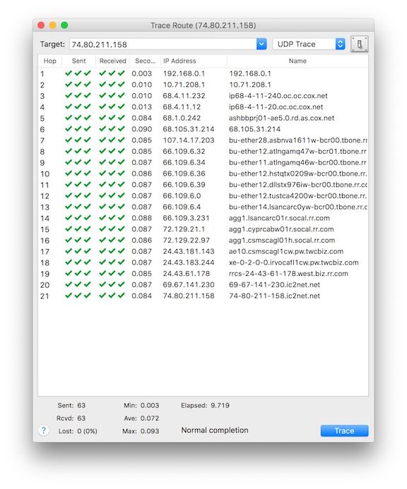

My interest performance is off about ¼ speed - I'm testing offsite servers I use all the time - some are my SMTP/EMAIL services and some are offsite servers I use constantly and ping often. If I ping my DNS servers at Cox those look OK so my connection via my my modem looks OK. My speed to test servers looks OK. Here is a trace route that show the problems. I generally connect to this server at 14-18ms and now it's running over 80ms.
appears to me that where I am picking up the problems is the "ashbbprjo1" hop which appears to be a cox.net server.

    1. Why do you say you don't see issues with the trace route? 68.1.0.242 jumps over 60ms. This entire connection used to take 14ms total. Now it has picked up 60ms which is over 4 times slower than original. Please supply your rationale for saying you don't see a problem.

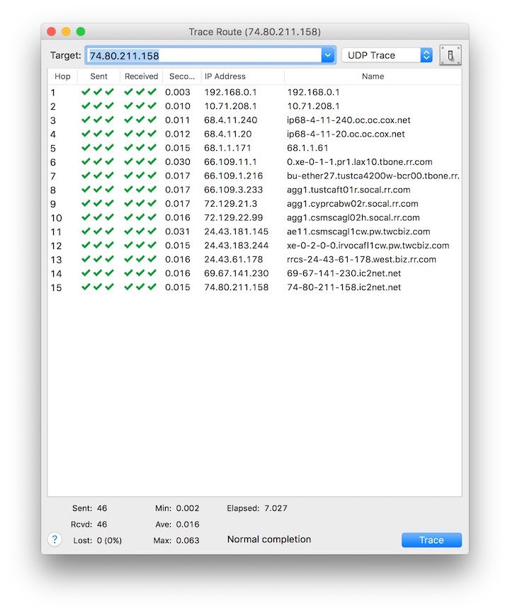

  • Here is a trace route for the local Cox name server. These look as they should and I am using my regular connection via my modem/router and wireless connection.

  • I do not agree. The trace routes show an unacceptable routing that is resulting in a significant slowdown. My provider for the server hosting on the other end of this agrees. He has submitted this to Cox as a formal request. He states that Cox has rerouted traffic via NY server and that is the source of the change in network performance - he has a number of customers who are having the same problem.
    When a single hop on this trace route is in the 80s that's a problem.

    Meanwhile you also have the information that this total routing used to work in 14ms total - i have checked it for years of usage and it has always been the same.

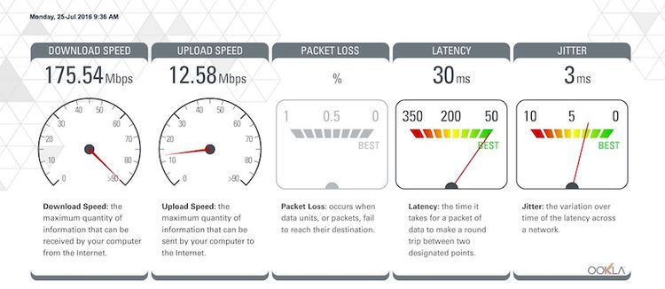

  • I appreciate that and my internet router is in a closet and I would need an adapter for my laptop I do not have. I do not have a standard RJ11 connector - my laptop uses a Thunderbolt connector. I don't see any instability on testing our wifi at all. Here is a test that shows jitter is very low.

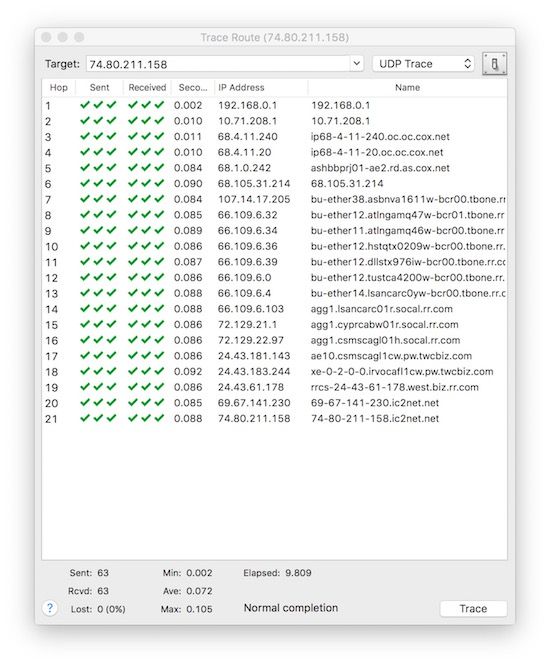

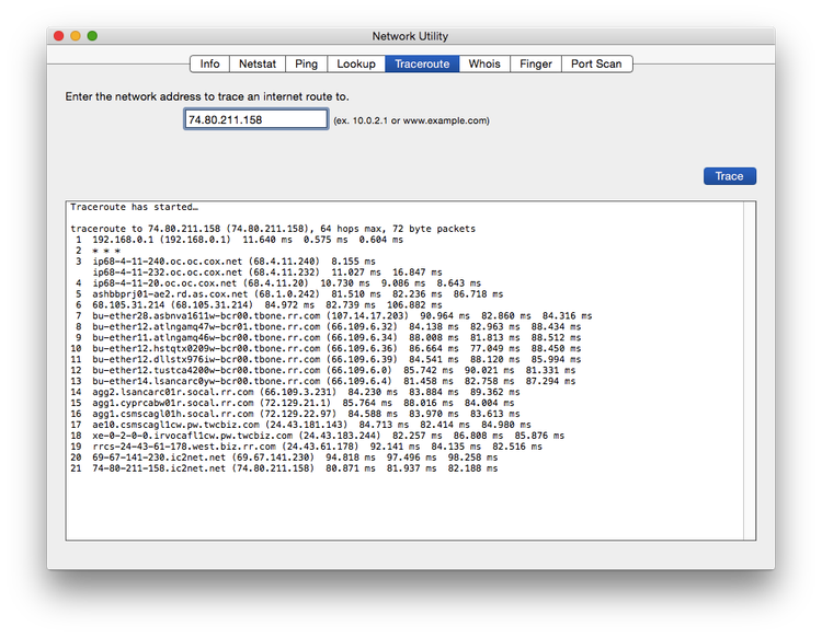

    Here below is a screen shot from another laptop in our home that is hard wired to the router.
    I believe you can see that the results are the same - I had to use a different utility which is good - this laptop had Network Utility - so we changed the application and the laptop to hard wired and received the same result.
    I don't know how anyone could look at this trace route, see 10ms on the router and then think the router connection might be the problem. That's just faulty thinking. Plus this routing continues to show up the same way for a month now - it's consistently bad. Now hopefully we can get off that idea since I did provide a trace route from a different computer in our home with hard wired connection?
