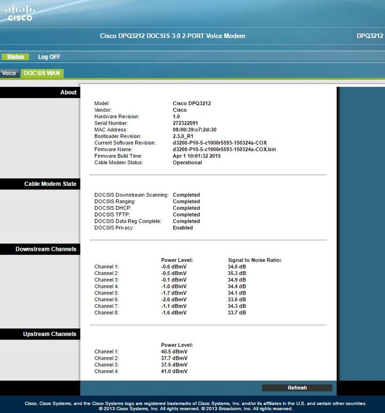

I have Cox triple play in Hampton Roads area. This is achieved via a Cisco DPQ3212 DOCSIS 3.0 2-PORT Voice Modem, with software revision "d3200-P10-5-c1000r5593-150324a-COX". Since I have installed the Cox service I keep having internet connection drop-outs, at random times. Initially I thought that it was my router, but replacing three of them didn't solve the issue. I have replaced the Cox modem and for a while seemed that helped, but now I have again problems. Even my phone conversations sometimes suffer. The only recurring thing that I can see is that on the 192.168.100.1 page, the "Upstream Channels" have Power levels of 0dBmV on two or three channles whan the internet is out. When I reboot the modem (unplug the cord and the internal battery), problem gets fixed and all the Upstream channels work (around 42dBmV). The downstream channels show around -9dBmV (+/-1dBmV). Any idea what can I do to fix this?

    I have replaced the cable modem and I have still experienced disconnections. The modem operational ranges are almost perfect.
    This is today's disconnection:
    And after pressing the "Reset" button on the modem:

    You are definitely having some sort of issue on the upstream, you shouldn't have channels dropping to 0 - again, that is usually a t4 timeout, and will cause hiccups and retrains.  Call in and have them check if your t3/t4 timeouts are accumulating more than 2 or 3 a day - ie jumps of 10+ in any given 2 hr period can be a cause for concern.
