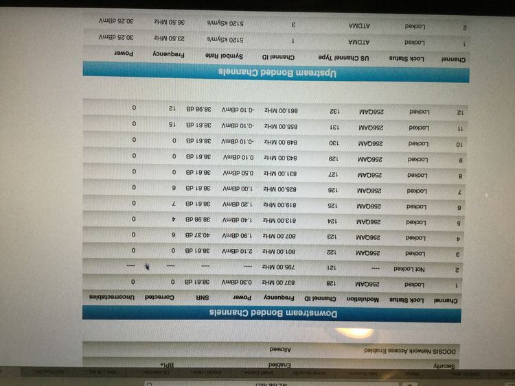

Intermittent slow internet speed
randomly down speeds drop to 0.8-4 when I get  down 120
1. removed a splitter
2. replace wire into house from outside
3.removed a cable "trap"
Now these drop in speeds don't last as long but they still exist. I don't know what else to do?!
No idea why its upside down?

    Standard speed troubleshooting steps:
    1: Test wired directly to modem
    2: Use multiple testers:
    http://www.fast.com
    http://speed.googlefiber.net
    http://beta.speedtest.net
    http://speedof.me
    I can't tell from the image, but I think it's indicating one of the channels isn't locked - I'd try powercycling the modem several times to see if it can get a lock on that channel.
    Did *you* remove a trap?  Are you sure it was a trap and not a filter/attenuator?
    Did *you* replace the outside wiring?  Are you using the proper cabling and crimping?
    Removing splitters is always a good idea, if possible.
