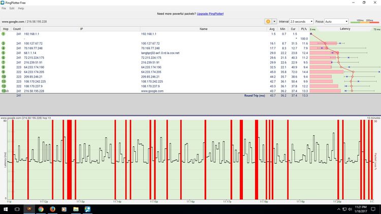

intermittent packet loss spikes in mesa az
been having this problem the last couple days.  Actually this problem seems to come and go for days/weeks at a time over the last couple years.
I have tried resetting the modem and router already, and you can see there is no packet loss to the router.  Unfortunately I'm using free version of pingplotter so i can't show you a bigger time frame for today but here is an old screenshot from 3 months ago when i had the full version
If the problem were on my end i would expect it to be consisent, but like i said, the problem comes and goes for days at a time then there's no problems at all for weeks, but it always seems to come back and i'm getting pretty tired of it.  For regular internet browsing, even streaming videos or downloading this doesn't pose a big problem just a little slow responses sometimes, but for playing online games this intermittent packet loss kills the experience

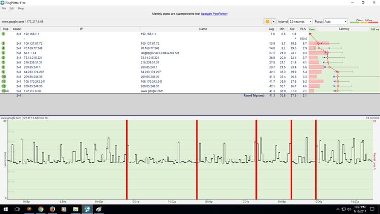

  • for some reason only the screenshot from 3 months ago showed up, maybe only one screenshot per post, here is the one from today with only a short time frame

    I think you are getting some bad data from hop 2 not responding to ICMP. I don't doubt you are having a problem, but I think it just isn't reflected in that data. Could you try with TCP? See here for instructions.
    Also, do the observable symptoms match with any of the times of high packet loss? Do they match with all?
    Last, can you describe the problem in more common terms? Loss of connectivity? Very slow? Do any lights on the modem change? Anything in the modem's logs? They should be on the 192.168.100.1 webpage, unless you have a gateway.
  • I see what you're saying about the 2nd jump, I don't know what that's about i'm not a tech expert but if i was having 100% packet loss then i wouldn't be posting
    on the image from 3 months ago there's no mystery jump, the packet loss starts after it leaves the router.  different modem and router by the way, same problem.
    i will try to install that WinPcap and get it working, i dont know if it will work on windows 10 though.
    right now it's taking abnormally long to download a file under 1mb and the download has actually failed 3 times now
    Yes, the symptoms match times of high packet loss.   I normally only run pingplotter when i start seeing issues, but when i have ran it at times when there's no symptoms there are is no red and no spikes and the internet is smooth
    I don't lose connection, the lights on the modem don't change, not sure how to access modem logs.

    The problem has progressed over the last hour, here is what the pingplotter looks like now
