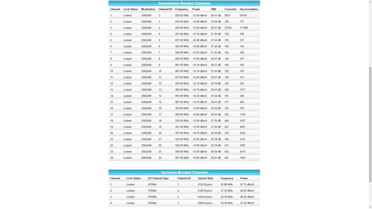

Hello everyone,
I have lately switched to the ARRIS SB6190 to increase my connection consistency with more channel capacities from the old motorola SBG6580. Since the change, I have had better experience until last two weeks. Yesterday and now today is little more worse feels like. There is a good amount of speed drop compare to 2 weeks ago (especially on the upload side). We use media streaming devices for our TV and movies and this has some effect on it time to time (not always).
I have noticed that I have a lot of logs for correctable and uncorrectable data. Do all these numbers of Uncorrectables look okay? If not, what are your suggestions?

    I checked from this end and the modem is reporting poor signal levels. Are there any cable splitters you can try bypassing and seeing if that helps?

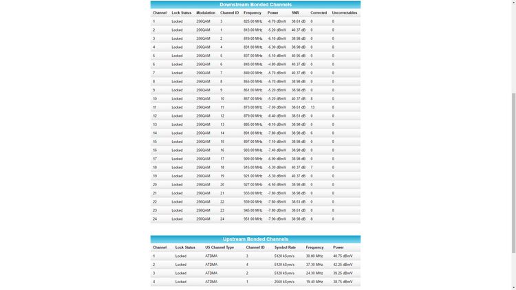

    I just did remove the splitter behind the tv where it splits one connection from wall to tv and the modem.
    I see some light increase on SNR margins. There is another splitter I believe in the wall, behind the face plate, which I can remove that if you want me to in about an hour.

    Just removed inner wall splitter as well.
    From outside cable box to the modem there is maybe 2 couplers (which are just straight couplers to connect to male end to each other).

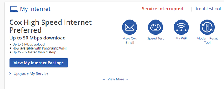

    power margins dropped, snr margins went up a little bit but upload speeds are under 0.50mbps, download speeds around 40-50mbps. I assume due to upload slowness, I am having slow loading, uploading times.
    what are your thoughts?
  • yalch's avatar
    yalch
    also cox test speeds are getting timed out time to time, just tested again and upload speeds are 0.55 or 0.40mbps.
