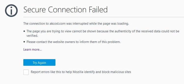

    I'm using Google DNS for both ipv4 & ipv6.  That said, with Firefox, https://akcost.com yields:
    Using unsecure http://akcost.com yields:
    Using the provided ipv4 address with an unsecured connection yields the same page you received, teck.  Same result using Chrome, both Chrome & FF latest 64-bit versions.

    Looks like HTTP is hitting the IPv6 address and not the IPv4. Those are different because A record and AAA record are different. Im not getting IPv6 because my ISP doesn't offer it. It looks like they don't even have the HE tunneling set up yet. Looking at the Wayback Machine, it  went down sometime between January and March of 2016
    My guess is the page is down to be fixed. If you look at the cache, the page was never a properly set up webpage to begin with, but gave file access to files on the server.
