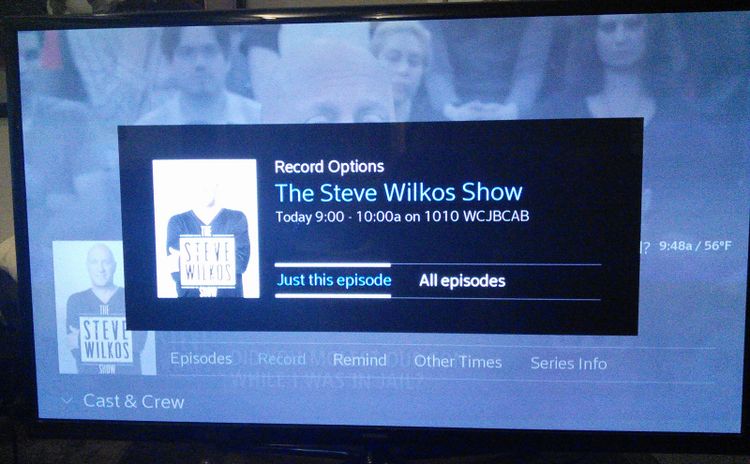

    Here is the CW right now, channel 1010, in HD:

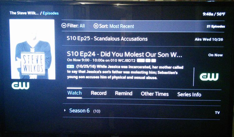

    If I select "Episodes", it only shows channel 10 (Non-HD)
    If I go back to live CW 1010 in HD, I can select "Record"
    ..and I confirm that I want to Record what is on channel 1010

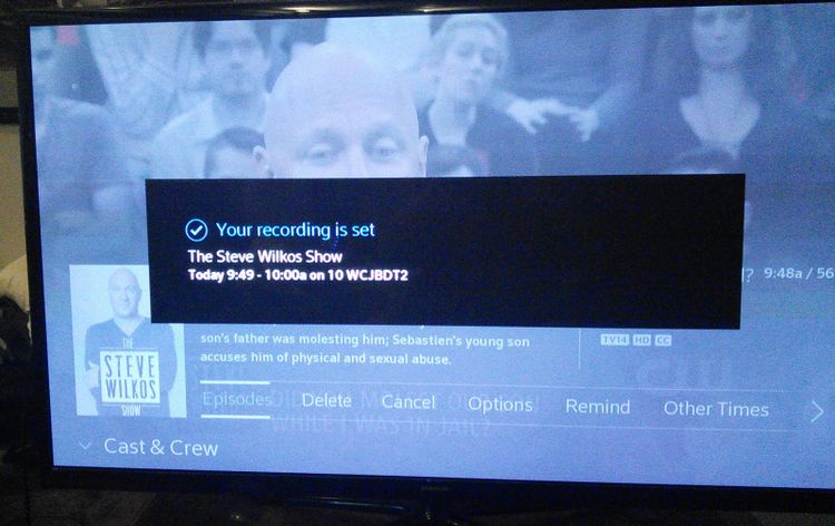

    Looks like it's gonna work, but not so fast..cause the DVR comes back and confirms the recording - but it's on the non-HD channel 10:

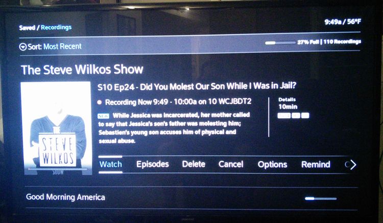

    ..and when I look at the actual recording in the "Saved" list, it is, in fact, recording the non-HD version of the current live program off of channel 10 instead of channel 1010.
    The DVR does this for all programs on the CW - it records channel 10 instead of channel 1010.  For all CW programs, only channel 10 is listed in all Episode guides for any series (1010 does not exist in the episode guide), so all series recordings are on channel 10 instead of 1010, even though I specify HD-preferred.
