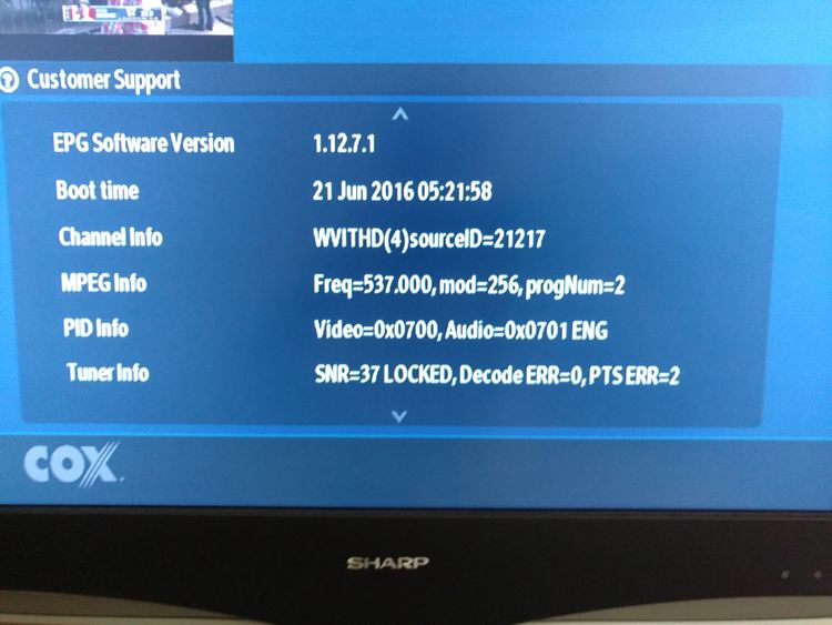

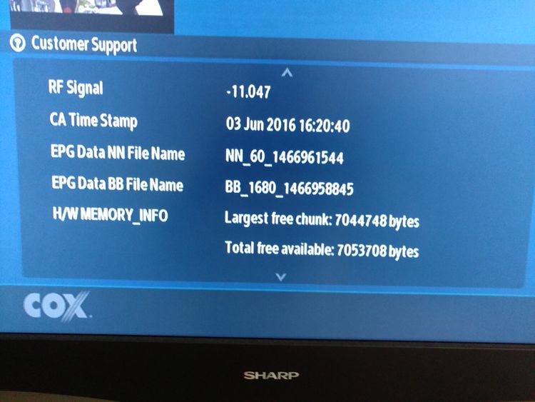

  • AllenP's avatar
    AllenP
    Valued Contributor
    As I said, the data came from the Customer Support screen of the minibox ... see here:
    The SNR is listed under the tuner info so I assume it's for the tuned channel.
  • Tecknowhelp's avatar
    Tecknowhelp
    Valued Contributor II
    Oh thanks. Those screen shots are useful for future reference. I guess I was asking for any data on what signal margins are for mini boxes. Looking now they use 256, so I would suggest a SNR above 30(35 is better) and a RF signal of +/- 15.
